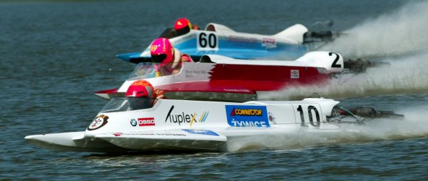

    though my involvement in pro hydros over the years and also from looking at photos on forums, such as Hydroracer.net, I've noted a number of differences between the design of boats used in the US, compared to those we use here in Europe
    Obviously, boat designs have evolved over the years to suit the style of racing, what's fashionable at the time and so on. Some of the differences in design I understand, but others leave me scratching my head, so I'd welcome your input guys
    My observations regarding European boat designs that are currently in use in the 0-125, 0-250 & 0-350 classes are:-
    Sponsons - I believe that the design and depth of sponsons on European boats differ from the US designs. From what I have seen, the depth of sponsons on European boats are deeper and (I gather) sometimes have a different design (eg chines). This is brought about because of the different courses that we race upon - lots of river courses in Europe than can rough up. The deeper sponsons provide greater stability in the rough water and more 'lift' in the front end, when turning tight buoy turns. Also the deeper sponsons and the front end lift helps get the boat up and planing quicker for the lemans starts we have
    Length, Width & Weight - I get the feeling that European boats are bigger (in general) all around - again to handle the rough water
    Other tweaks - to help with the modified lemans starts, a number of the boats have a centre wedge infront of the foot/prop that runs about 18" to 24" towards the front of the boat. This allows the prop to be run deeper to get better 'bite' from the lemans start

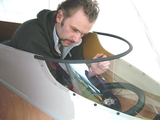

    The above I think are pretty much obvious differences, but the one that has me scratching my head is the fact that some of your pro hydro boats do not have perspex screens. I can honestly say, I have never seen this in hydro racing in Europe as all of the boats run a screen made from Lexan or another poly carbonate material.
    Can I ask, why some of you guys prefer the 'no screen' approach. I'm guessing that it's a personal choice, as I have seen boats with perspex screens and others without. Invariably, here in Europe the driver either looks through the screen, or half through/half over (as shown in the pic)
    I'd welcome any thoughts on the matter, and any other input regarding boats designs

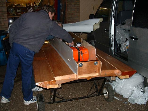

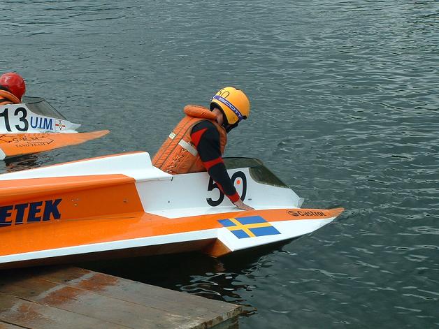

      There's kevlar there alright - just have a look at the pic of the guy, Paul Jillings, fitting something (I forget what) in the front of the boat. Over his left shoulder, all of that dark yellow material is kevlar. It was a brand new boat build by Dickfors in Sweden and as such, all of the kevlar was laid up on the inside of the cockpit sides rather than the outside (far neater that way)

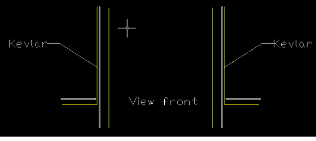

      As far as the UIM rules are concerned, it's pretty much all of the hydros that race in international events need kevlar reinforced sides, even OSYs*. Rather than misquote the rules, here's an extract from the UIM rulebook that explains what is required.

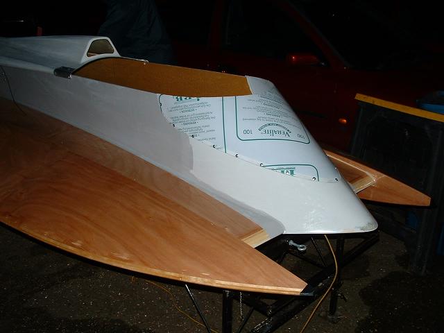

                  One of the things I didn't make clear (when I posted details of the UIM rules) was that as well as covering the cockpit sides, the kevlar needs to extend onto the deck of the boat by a certain amount
                  What the Dickfors team have done when building the boat in the picture is very neat. They have lapped the kevlar under the deck (see image). So rather than the kevlar being on top of the deck, it's on the underside of the deck - neat eh?

                    I did see the kevlar on the cockpit sides, but I was wondering about the deck joint. I agree with having the cockpit sides reinforced with kevlar, but laying it down to the deck doesnt make a whole lot of sense to me. Thanks for the reply.

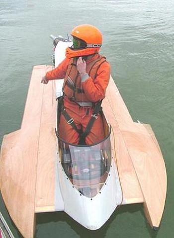

                          the european boats look very narrow. How long are the boats? How wide are the boats between the sponsons? Are there many builders or do racers build the boats themselves?
                            Bottoms
                            They look narrow because they have steps inside the sponsons that look to be about 4" wide but the step stops just behind the sponson backs and the air traps continue on to the rear pads or shoes. These boats are meant to pack a lot of air and the steps inside the sponsons help to reduce the amount of air that is lifting the front of the boat.

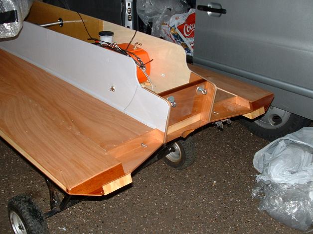

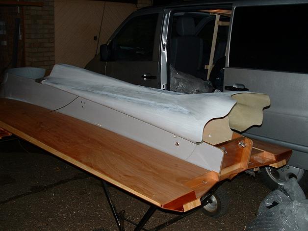

                              I'm not sure about the dimension between the sponsons, but MJR is right about the stepped inner sponsons and the reasons for this (you can see this clearly on the photo on the upside down, soon to be repaired, boat) http://www.hydroracer.net/forums/att...achmentid=6061
                              In terms of length, an 0-250 boat is circa 4m
                              Attached are a few more photos that show other design features
                              Both of the boats in question are built by Dickfors in Sweden (the upside down one is a few years older than the other). In recent years there have been many boat builders from different countries - the ones that stand out are Italy (Popoli & Mostes), Sweden (Dickfors), Estonia (Kala) & Germany (Lucas).
                              You'll find that in the smaller classes (OSY & 0-125) there's more of a chance of self builders, rather than buying from a boat builder. That's not to say that the others, Mostes, Dickfors, Kala & Lucas haven't been very successful in building boats in these classes.
                              In the 0-250 and 0-350 classes these are pretty much dominated by Mostes & Dickfors these days, although again there have been manufacturers of one off boats (again very successful). Two that spring to mind which were composite copies of other boat designs - composites are also creeping into OSY and 0-125. If we take the 0-250 class (the one I know best) the field is pretty much split between Mostes, Dickfors and the odd one off and self builds. It's strange, but it's only really the Italians that have been able to extract the full potential out of the Mostes boats, whereas the Dickfors are used by a host of different nationalities
                              The market for boats is not so large as it is in the US, but in the last 3 years I calculated that the Dickfors guys have built 8 boats - from OSY/0-125, 0-250 (most popular) and 0-350. It is a real family run affair - the two oldest brothers, Olle & Johan both race, Dad (Anders) & younger brother, Åke, crew and they are all involved in building boats, with the help of other relatives and friends. Olle & Johan are very successful - Johan #50 was the 0-250 European champion in 2004 and both of them are always placed very highly in the results. The 'problem' is that they keep on selling their successful boats, so for the last 3 years in the winter they have had to build new ones to race!!
                              Going back to the design of the European boats, compared to the US, I get the impression that there's more shape (a la aircraft wing) in the decks on our boats - again, going back to the point made by MJR of lift.
