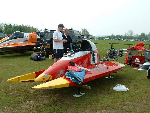

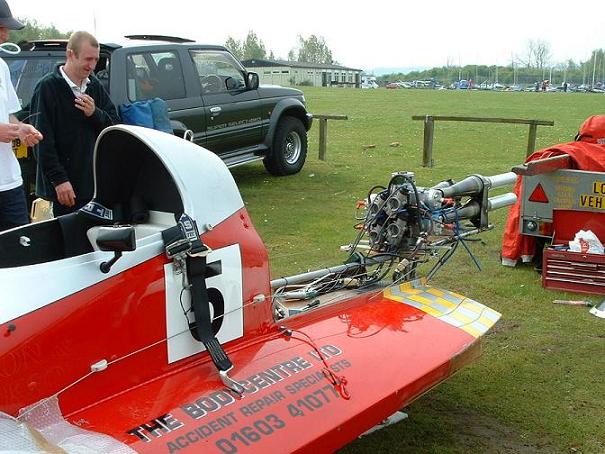

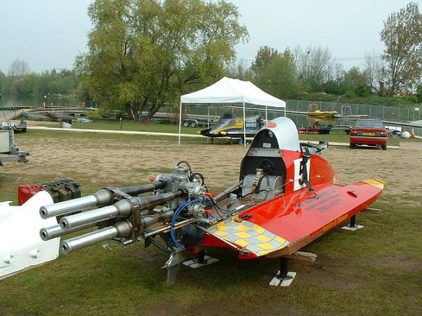

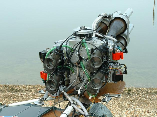

    It occurred to me that you guys probably have not seen an Arens 0-500 engine before, as Arens' engines in general have not made it across the pond yet
    So, to rectify matters, here's a couple of pics!
    I'm told (by those in the know) that parts of the engine design, eg the cylinders, are based upon the Rotax engine
    I've got to admit that I've not a tremendous amount of first hand experience of the Arens engine - there is only one is the UK and the guy who runs it had a whole host of problems (to the extent that he wants to sell it!). But what I have seen, for the 0-250 and especially the 0-500, is that they demand a huge amount of air to run properly - so much more than the Rossi and VRP engines. When I asked Holger Arens why, he shrugged his shoulders and said "they just do!"

      There is a 250 Arens in the states. You are correct, it is all modeled off of and uses rotax kart parts. I have seen it run a few times, but never with any great success. I think it might be for sale as well.....

        The Arens engine was run on the back of a Russian designed/built Fort trimaran hull similar to this (although this has a Rossi on the back)
        The Fort hulls were originally designed for the König engine, but with a little modification, the new style Rossi / VRP engines could be run on them too. Nowdays, the hulls cannot be used in international racing as the safety capsule only has a 1000Nm rating, so a new breed of boats have been designed and built. Most of the newer boats have adopted a tunnel boat (catarmaran) hull design - see #53

          Corin, I have the only one in the United States, I bought it used from the Brinkman's...... The only good part about this motor is that the parts are available from many Kart shops. Pistons, rod, Cylinders, Gaskets..... It appears to me the only part that Arens made is the Crankshaft and Crank case..........I've E-mailed them several times for some information on this motor but got no response.....Currently I'm using it to hold down the concrete floor in my shop........It seems to be doing a fine job.....
          Seriously though, the first time I had the engine apart It was obvious that the transfer port timing and area were not sufficient to produce results that would keep up the newer motors. Keep in mind that the cylinders that Arens uses were designed and manufactured by Rotax for their Kart engine, its only rated at 32 HP.
