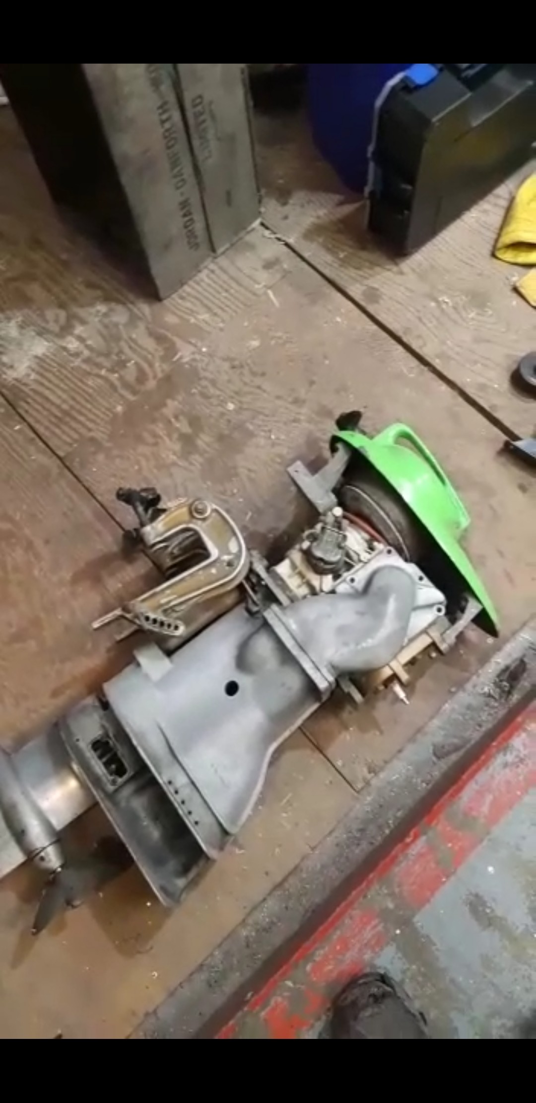

            First is a screen shot of a vid I took... I already pulled the motor down, so nothing better and long story, but that motor was displayed at a boat show minus much of the internals... cobbled together to "look good", but that was ahhh... over 25 years ago!

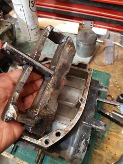

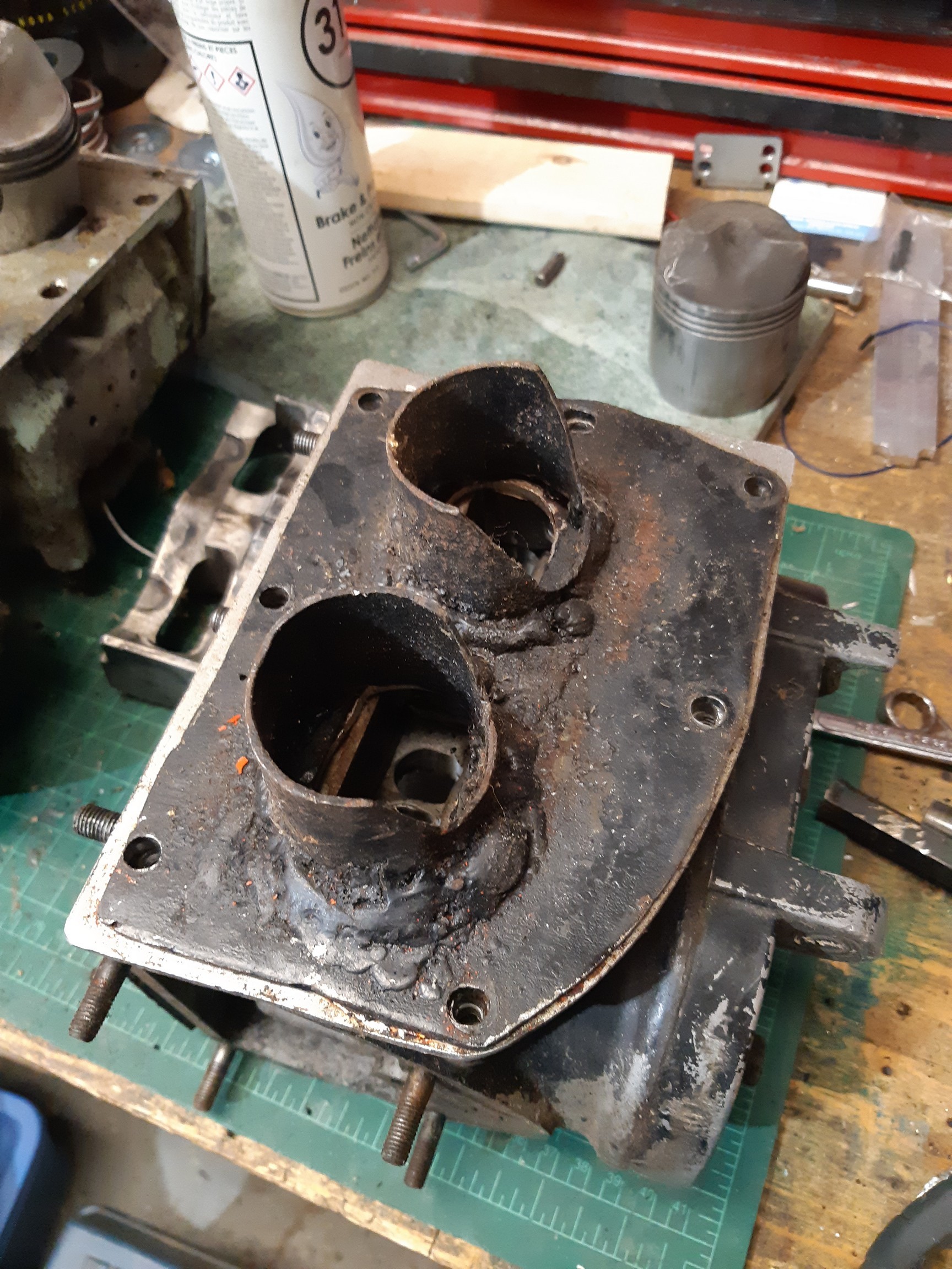

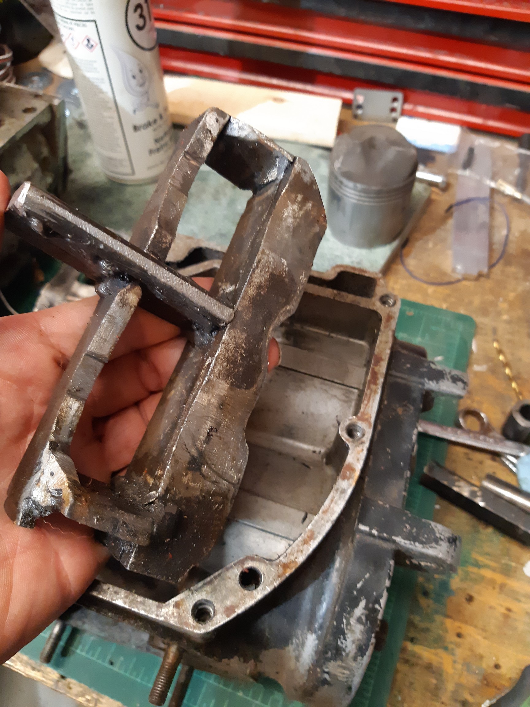

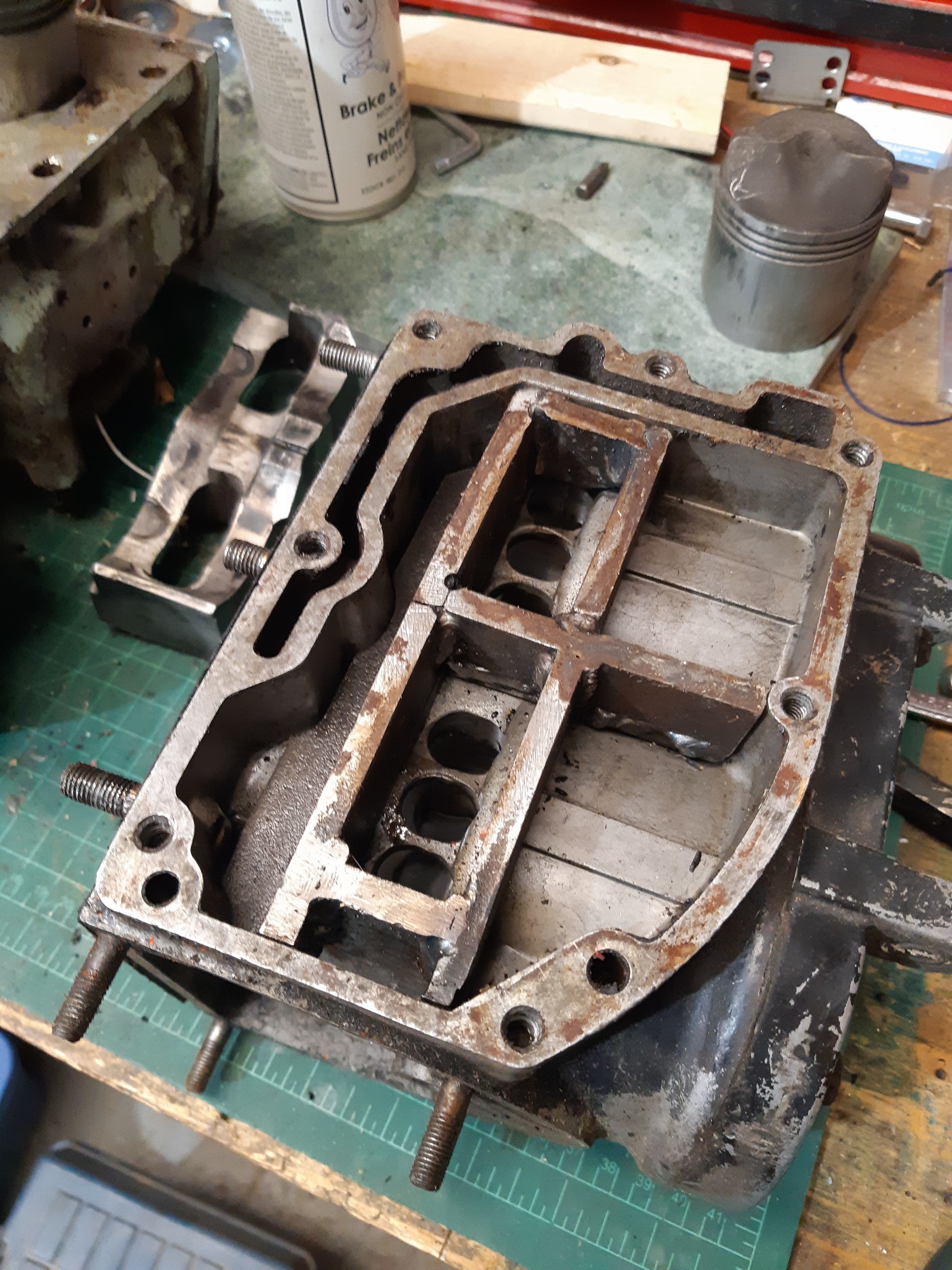

            Next ones are from a head that I actually tried... I got a bunch of stuff from "a guy" that was a notorious tinkerer, and he had built expansion chambers to fit this contraption, but no longer had them. For giggles I remember putting this on a drive train and ran it with the exhaust like seen! made no power... but was almost as load as the corn popper... now taking it apart I'm amazed at the effort that went into making that exhaust splitter! Looks to be done with stick welder, a file and maybe a grinder? anyway, that's another "good" rotating assembly but I'm not sure yet what the reeds or reed cage is.
