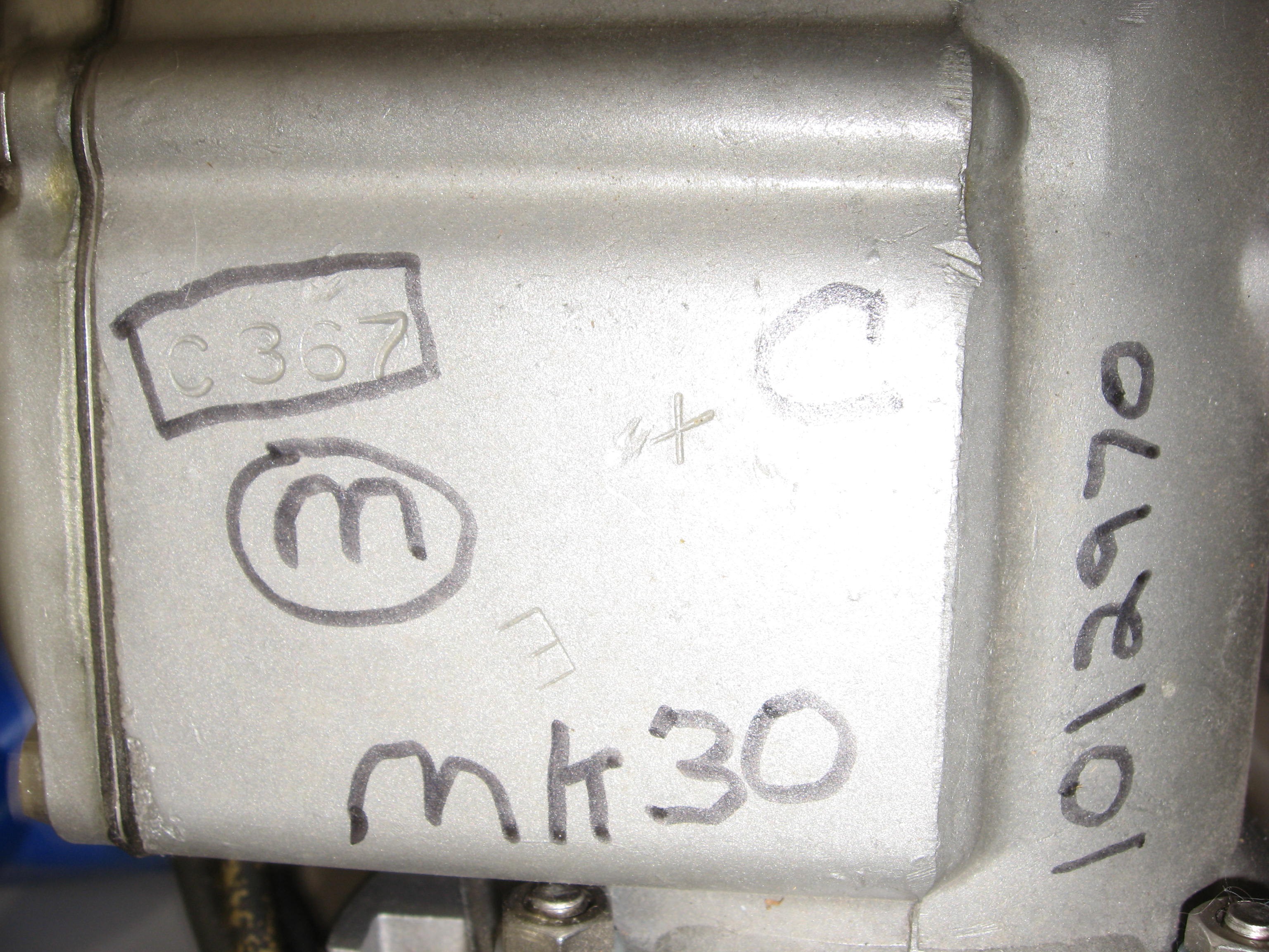

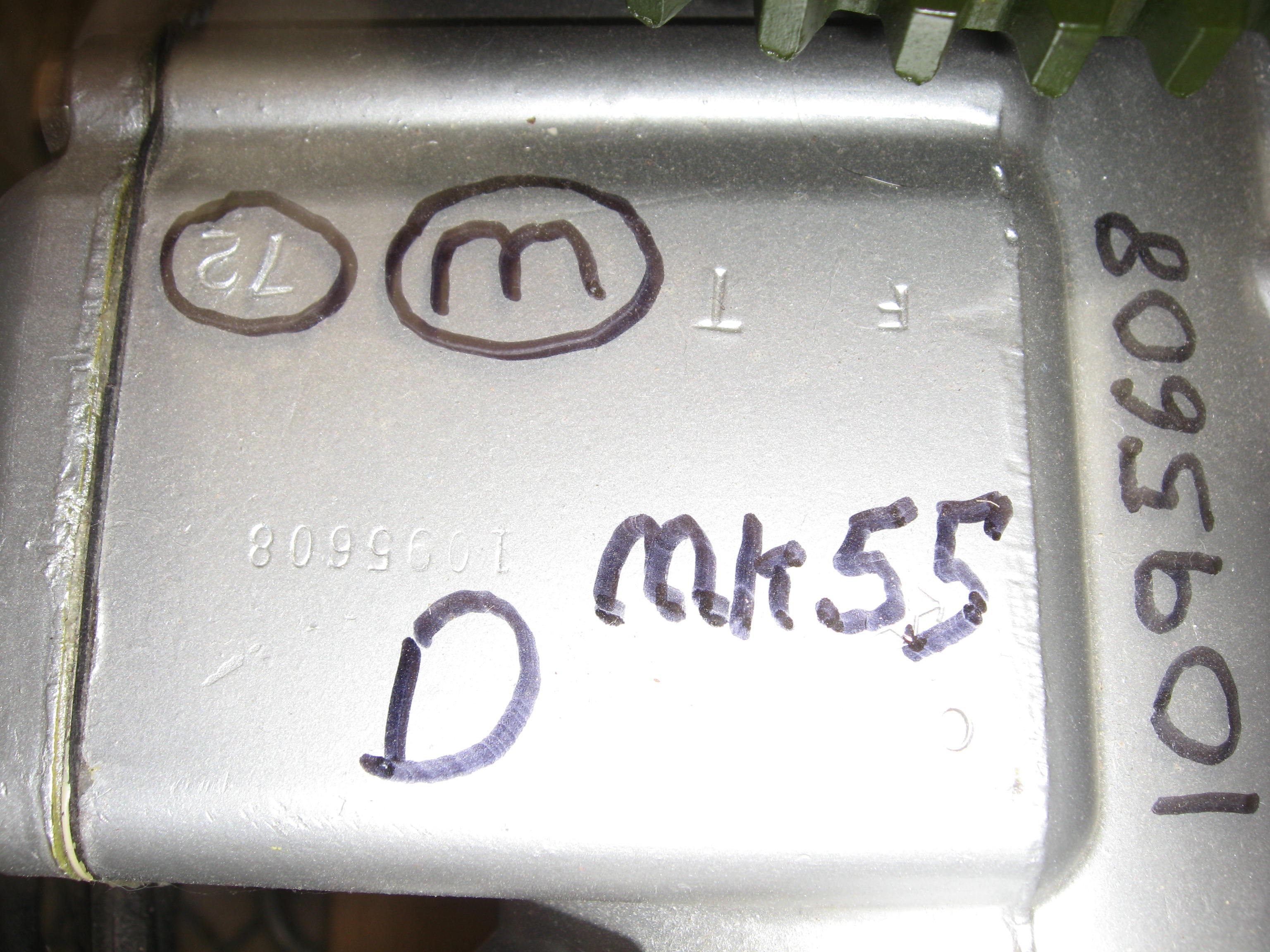

              I have attached a picture of a Mark30 block and a Mark55 block with their stampings. The 736 X and H were likely identifiers of machines or machinists involved in the manufacturing process since they show up on these two fishing blocks as well. I think you have a replacement service block with no serial number since serial numbers were stamped with characters 1/2 as tall as the 736 XH on your block (see the Mark55 serial number stamp). Click image for larger version

                          Ok, before this thread goes further into speculation, it should be updated to clarify a couple things... All the Mark30H powerheads came off the Mark30 production line. They are 100% the same powerhead but 30H had light flywheel, full carb butterflies, shift linkage delete and a non-electric Mk55 lower pan. Those are the ONLY difference between Mk30 & Mk30H powerheads. You don't have a "763 XH" serial number, it's a standard serial number 1023440 stamped in the same, correct location on the water jacket flange as ALL the 30ci Mark30 blocks. (40ci blocks were stamped on top of the #1 cyl water jacket) The 763 you see is just a standard factory machining stamp to match the block to the crankcase and you should find a corresponding 763 stamped into the crankcase if you look down, between the crankshaft & magneto drive pulleys. Those three numbers match on all the Mark30's & Mark55's in some manner from before, after, and during the factory "H" racing engine production. The X is also shown above on my own Mark30 fishing powerhead in my previous posting which has been professionally restored to 30H spec and I have confirmed with a couple friends who also have X stamps on top of their 30ci block. I know my block did not come with a Quicksilver racing tower & gearcase. Could you shine more light on the Mercury Marine Performance? (Mercury Racing?) tech discussion because that is specific info none of my own mentors or collector experts have ever mentioned. Who was that tech because it would be nice for that person to share that knowledge from a memo, chart, blueprint, document of some sort to help others I.D. their blocks.

                              A few photos that may help out. This block, #1025774, was sourced from a late 1956 MK30 service powerhead. Again, there were no physical alterations made to the MK30-H blocks as was indeed the case for the OEM MK55H blocks in 1956 & 1959. The machinist marks shows as B220 on both the top of the block and crankcase cover. The serial# is harder to read and stamped into the side of the water jacket casting adjacent to cylinder #2 on the intake side. These marks do have significance as they indicate the block and case cover are a matched set. The other stray marks including an "X", "M", "F", "Z" and even a cute little 3-leaf clover are irrelevant. Someone at the plant carried a stamp and marked the block when they completed a specific task. No Urban Legends here.
