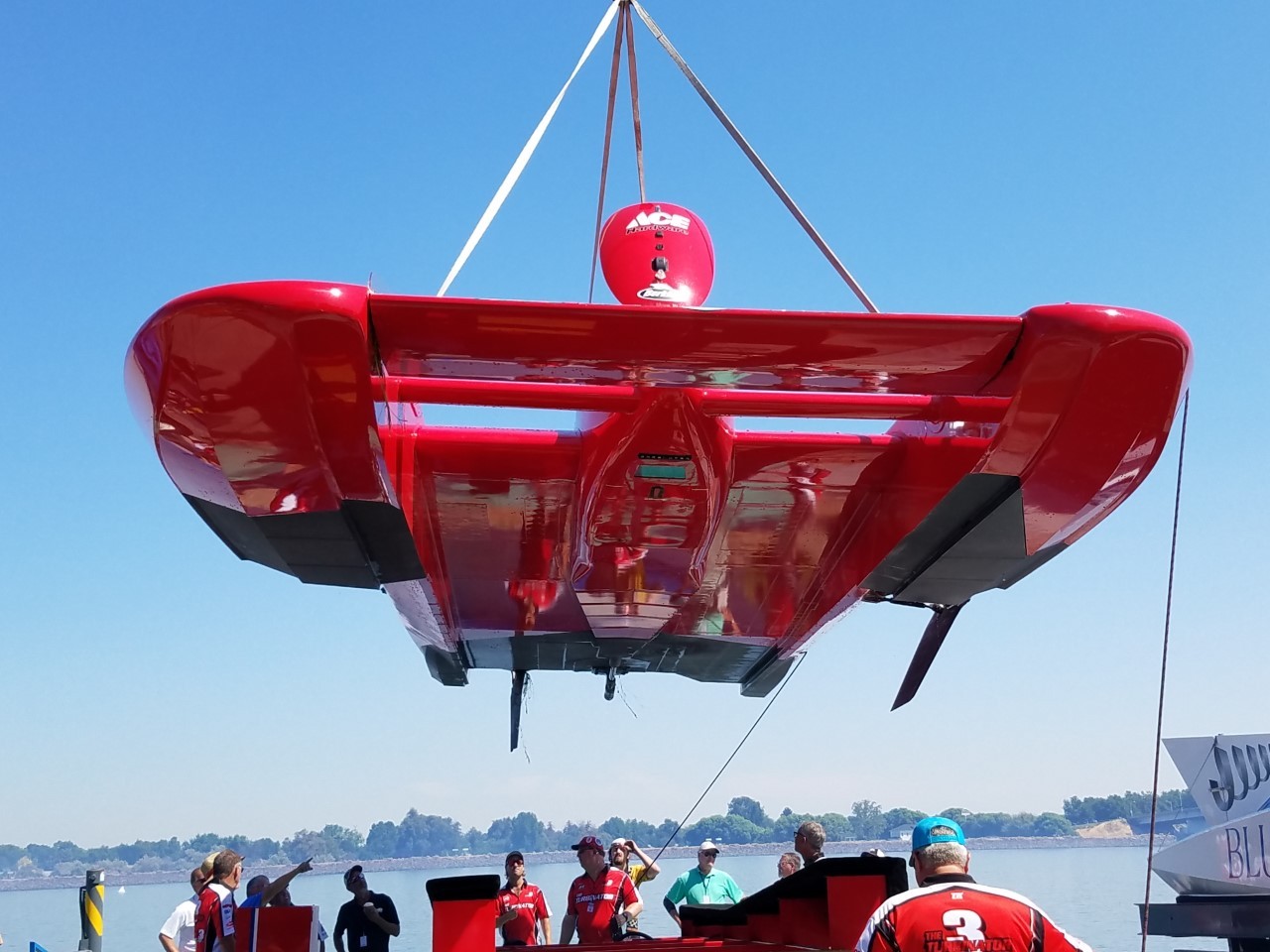

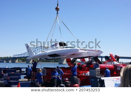

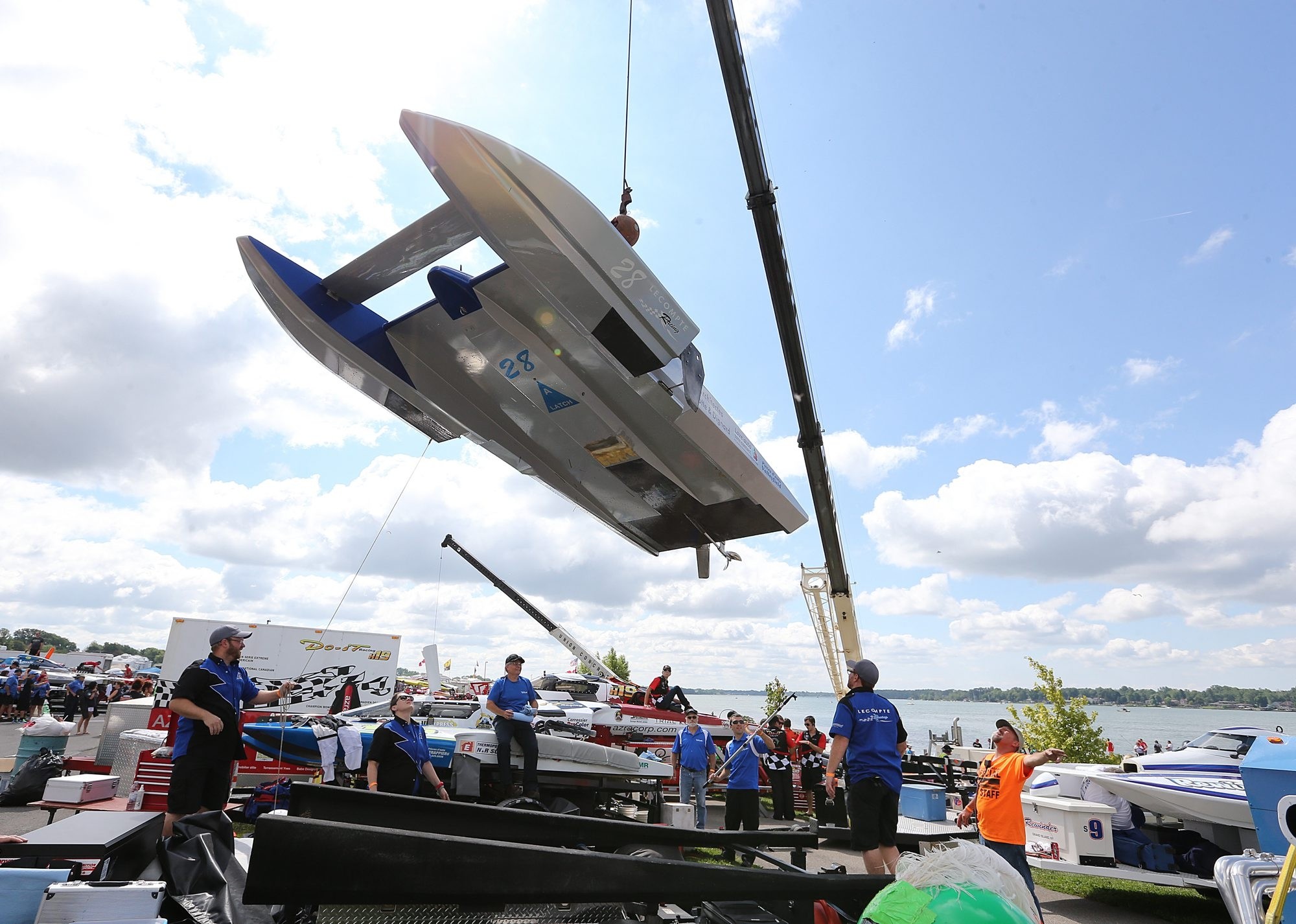

              Here are some pictures of what I'm thinking of doing to the bottom of my hydroplane.
              I have noticed teams using some type of *black paint* on the back of the sponsons and on the rear planning surface. That is what got me wondering if this actually helps tops speeds or if it's just "Snake oil" as some have suggested.
              I race 300ssh, so the suggestions of spending my time & money on motors/props does not really apply here, with sealed motors and our props issued to us by the APBA, boat design and efficiency play a bigger role in higher tops speeds.
              I have noticed some fellow races out here in region 10 "dipping" or "coating" there turn fins in a very similar *black paint* as to what is seen on the bottom of the bigger budget hydroplane teams, But I'm yet to find out what this mysterious *black paint* is actually called... and better yet... does it actually work?
