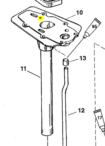

    Which holes in the adapter plate get blocked for drystacking?
    Look for the small (about 1/8") hole to the aft of the exhaust pipe... highlighted below. RTV or similar...no need to overdo globs of it and make sure you don't disrupt where the gaskets rest on the plate.
