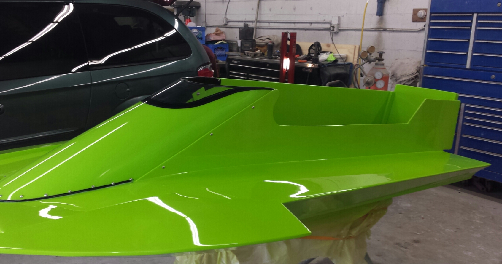

      After i built my boat i painted with automotive base coat clear coat. It cost me $20 per pint plus clear and reducer. In the event my boat gets hit i have more confidence in myself getting a perfect color match blending with clear. That is just my preference though. Gotta love the shine of clear.

        Yeah, I know it's going to get dinged and all, but I need a pretty paint job (and not just for personal vanity reasons). IF things go as planned, you'll understand :-)
        I have some experience painting cars and body work, but wanted to make sure auto type paint would be OK vs some special marine paint.

          auto paint will be fine if that is what you are familiar with... prep work makes all the difference on finish as you are undoubtedly aware. I used auto clearcoat on my boat and holds up great - easy to touch up with clear coat in a rattle can too... buffs out great.

          My boats are painted at Unlimited Auto Body with auto paint then clear coated holds up well but thet are in an enclosed trailer all the time the paint holds up well.
        Duplicolor has "paint shop " pre reduced paint in about 10 colors about 25 $ a quart . It sprays well and with a little clear over it - holds up .
