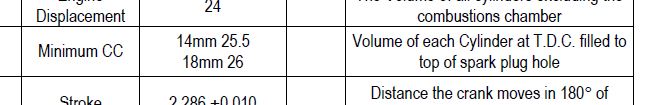

    Go to the APBA website and click on the ‘Resources’ tab. From the ‘Resources Type’ drop down menu select ‘Technical Info’ and click the ‘Apply’ button. Now you can scroll down to the ‘Stock Outboard Technical Manual’ where you can find the information you are looking for on page 15. You would then take the information gained from doing this procedure and look at the spec for your motor on page 71. I pasted a pic of it below; I will explain why later.
    This resource will describe the official recommended method of measure but it won’t tell you how much material can be removed: that would be a function of the current state of your equipment. For more general information on the measuring process, search terms like CC Combustion Chambers or Measuring Combustion Chambers at the University of You Tube.
    I pasted the pic to help set up a question I would like to ask. When you look at the spec you see two numbers 14mm 25.5 and 18mm 26, is the mm reference to the spark plug and the following number the minimum CC volume for that sized head? I believe this to be true but would love to hear the response from a certified inspector.

        14mm refers to the 14 mm spark plug head and 18mm refers to the 18mm spark plug head that has a bigger plug hole..
          Ahh yes the answer I was looking for 25.5 now I can go to work making this motor have more POWER..!!!!! thank you very much...
            The squish ring must be retained.
              fishinworm, First off I would CC your engine with the uncut head on it. You can compare volume of each cylinder to use when you set up the head to be cut. To give you a rough example of volume of the cut, I use the ''H'' dimension in Inspection manual and a .010 cut will remove between .868 to .888 cc. And as Jack said, the squish ring has to still be evident. An Inspector can use a scribe, or edge of a pocket machinist scale, or even a finger nail to check for the band edge. Like I said check the cc's before you cut the head.
