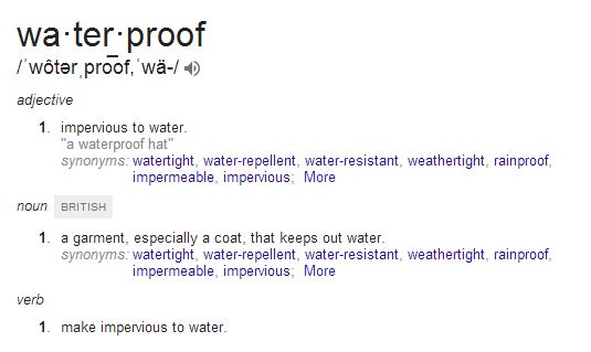

            Interesting: water resistant not equal to impermeable or impervious, the latter two are conclusive while resistant is not but depends on conditions.
            water resistant
            able to resist the penetration of water to some degree but not entirely.
            impervious
            not allowing fluid to pass through.
            synonyms: impermeable, impenetrable, impregnable, waterproof, watertight, water-resistant, repellent; More
            impermeable
            synonyms: watertight, waterproof, damp-proof, airtight, (hermetically) sealed, vacuum-packed, zip-locked

          What's the source for the definition, synonyms, et al? Because the industry does NOT hold the terms "waterproof" and "water-resistant" to be synonymous. For instance, Weldwood Plastic Resin Glue (the powder and water stuff) is described as "water resistant," so joints glued with it should not be immersed in water for extended periods (not wet-moored in a marina), whereas Weldwood Resorcinol Glue is "waterproof."
            Oxforddictionaries.com
            On impervious definition the water resistant synonym got in there which I do not agree with but it is there.
