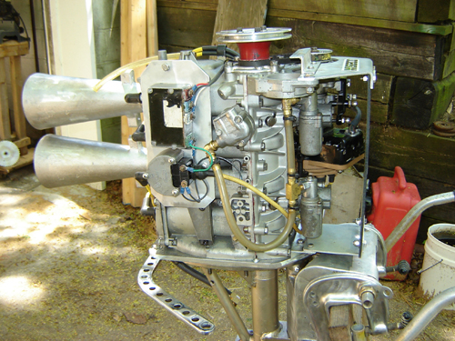

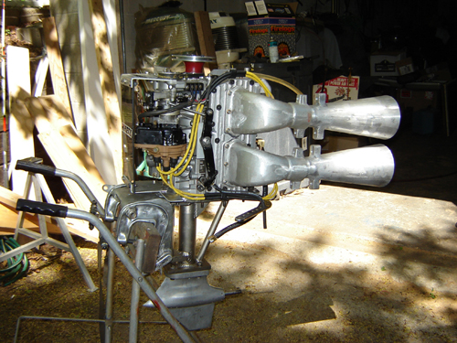

                    Dave, just finished the D Mod (Merc 500) and should be ready to run Franklin, Pa. in DMR. Thanks for all the imput in putting it together. Enclosed are a few pictures....Bob Rusnak N-96
                      looks good!!
                      Hey Bob,
                      no problem.. Glad to help another get on the water.. I would focus on maybe shortening up those wires some.. That;s a lot of travel (work) for that igntion system.

                          Had some minor problems with the 44 that took 4 heats to fix. Buy the last heat on Sunday it performed very well. Used .067 jets, Ql77JC4 Pulgs, .300 timing. Pulg color looked pretty goog. Broke a steering bar bolt on turn two, last lap. Never have broken one before. Picked a 500 cc hydro wheel to try, a little two small with the Konig 14-15 gears. Tried to see you at the race but our paths never met. Thanks for the help...Bob & Don Rusnak N-9 N-96

                            Hey Bob,
                            That;s great you got it worked out.. Ya I was over to see George and I guess we missed each other and vice versa.
