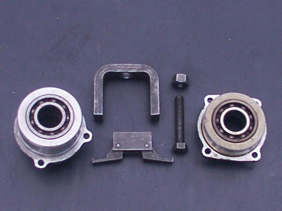

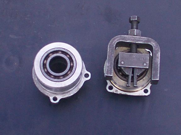

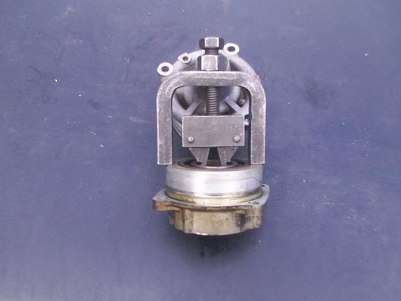

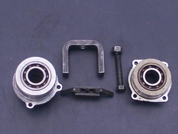

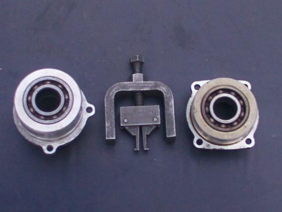

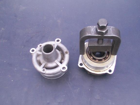

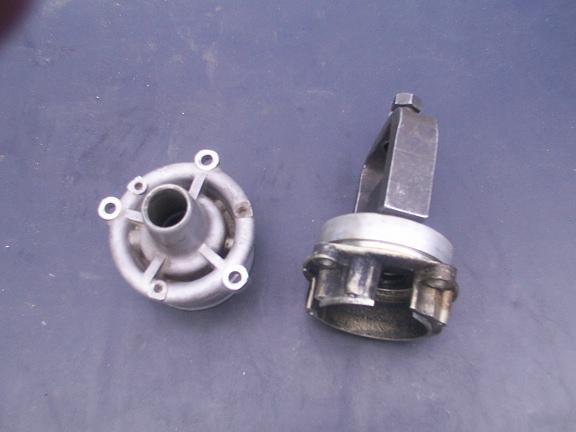

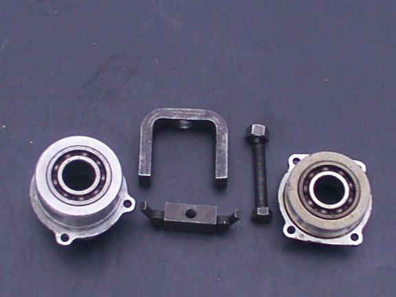

    END CAP BEARING PULLER FOR YOUR WRENCH HEADS! EASY TO MAKE, THE PICTURES SEND HOME THE IDEA ON HOW TO SIMPLY BUILD THIS ONE. You can't buy these anywhere anymore?? for $6.00 bux is all I paid some years ago.
    Easy To Make!!!! The more than a dozen Jpegs of this bearing puller for end caps from KG4 to Mark 75 and everything in between?? and then some? The design is that it will not break the installed seals positioned properly on the bottom of the inner bearing race to pull up and pulls out the entire bearing by its center race, by gently turning that nut with your favorite fitting wrench!

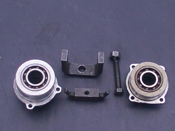

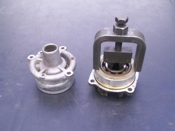

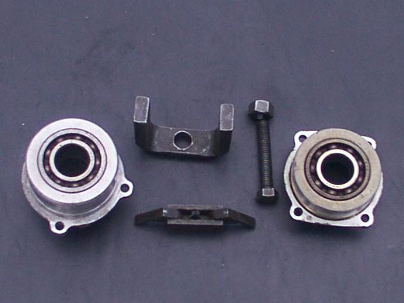

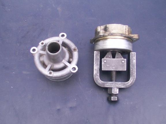

    End Cap Bearing Puller Batch 2
    Some more pictures of the end cap bearing puller.

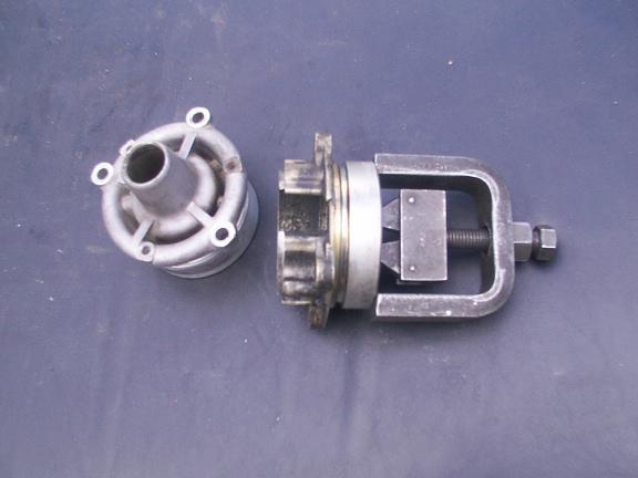

      Last Puller Picture
      Last Puller Picture.
