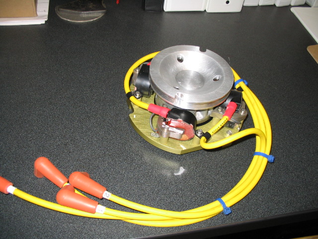

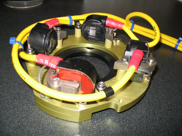

            I do have a new ignition that is working well at least on My C in testing. It is a direct fire self energizing system that is simple to install. It can be set up with fixed or variable timing. I've sourced new modules as the ones on the first batch are NLA from Phelon. The new setup will look very similar to this one with the only real difference being lower wire routing which I like better. The cost is $590 and includes everything down to the spark plug wires, rope plate and even the diodes for the kill switch. The only thing you need is a Merc flywheel cut down to the drawing I provide so you can bolt it on. Here is a photo of the first generation. E-mail me with any questions. The second generation units should be ready in about 3 weeks or so.
            Steve Roskowski

                How well does this work?
                Steve Roskowski
                Steve are you still making these ingnition systems and what are you asking for them? Aynone out there using this system, and if so would you please provide some feed back on how it works? Thanks to all that reply,
                Gardner Miller
