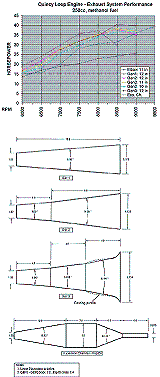

              I hope this comes through large enough that it can be read. It is the horn or bell dementions for the alky merc motors and the horsepower spec's in relation to rpm's. I can e mail the full size image to anyone who is interested in having it. But the info suggests that a stinger pipe is a home run. This water injection deal sounds pretty interesting too. Does anyone have any photo's of a working water injection opperation??

                      Bob Goller set a number of records with an expansion chamber 30 merc. His engines still hold a few. John Mawk (sorry if I spelled your last name wrong) has one that runs well too. I am working on one as well, still don't have all the bugs out, but it goes faster with every change. The design of the pipe is all important. I do not believe that an alky pipe will work, higher power engines need large angle divergent cones. I think a more conservative design is necessary
