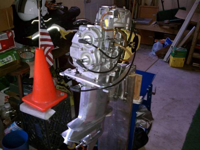

                    Done!! I will take a pic tomorrow. You think it will be a speed or safety rule infraction. Sorry, had to say it.

                      http://i695.photobucket.com/albums/v...a/IMAG0668.jpg

                        That's funny..... Certianly a conversation starter!!!!
                        Gardner Miller
                          Cool

                            Hi Mark
                            Where you put the spark plug in is the exhaust pressure release. Not for hooking up garden hose to run engine. I hope you knew that.
                              Originally posted by Warren Huff View Post
                              Hi Mark
                              Yikes!! Just saw that there and assumed. At work now. I see from my pic that is in the mid unit, not the power head. The 102 doesn't have the exhaust release, does it?? I don't see the water plug in the pic. Where is it on the 302?
