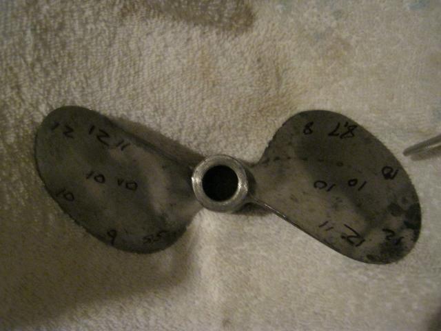

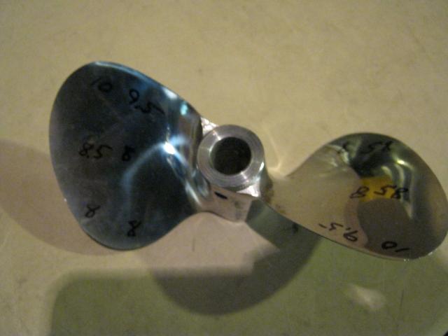

                              Props - 20H 1-1 non conversion
                              Here a couple of props, 1) is a6x9 Kamic, the other is a 6 3/8 x 10 1/2 Cary, $50 each.
                              Ric - 206-283-4773 ricstr4@gmail.com
