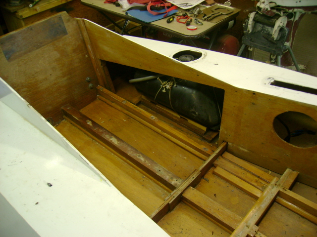

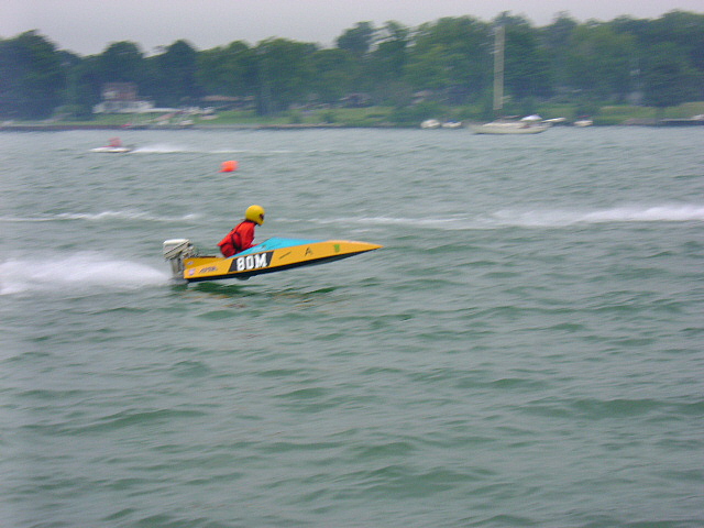

I'm sure you can get 20 different answers to your question here on HR. Keeping that in mind take a collective overview of peoples suggestion and see what works out for your hull application. This was my sons set up in his "A" marathon that worked. I really didn't care for all the weight being on the left side of the hull but it didn't seem to bother him. Try not to get the tank or tanks to far back as it hinders planing time. If you can position them as to not affect the balance point of the hull as they empty it will help with consistant launch and landings as your wave jumping.
Good Luck!Last edited by Tomtall; 03-02-2012, 05:45 PM.Tom L.
