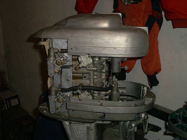

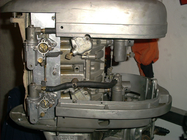

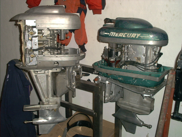

    Does anyone have any idea if this will work? Should I link the intake ports together? Will it run on gas? Progressive Linkage or all together??? Someone must of tried this?

          You will want to utilize a progressive linkage such that the side carbs do not open until the front carbs are open full. Also, it looks as though the carbs are piston ported. We tried that on an alky 66 with mixed results. You will not want the side carbs to open until the RPM range is optimal for the side carbs to function, in their resonant frequency if you will...Also you will not see any real performance gain in the stock configuration. You will need to raise the exhaust ports to get more RPM. In a stock configuration the engine tends to have enough intake capacity. Will be more dramatic if utilized on a 44 or 66 than a 40 or 60 cu. in. Merc (same size reed blocks in each engine) Have fun experimenting! Just as an FYI, a 66 6 cylinder is almost exactly identical to a 4 cylinder 44. Just has two more cylinders (same goes with the 40 to 60).

            WOW, great info. How high would you take the exaust ports? Do I still have my choice of fuels or will this only work as an alky? If methenol is the only way is the stock compression ratio ok? This is a 44, assuming I get it running good what size boat would it be safe on?

              I tried to engineer something like that before. But I couldn't figure out how to put a set of reeds behind the carbs.
                I would start with raising the exhaust .030" and go from there. Be conservative. As to gas vs methanol, both should work. Side carbs really came from a need when people were running these on alcohol. Because methanol uses 2 to 3 times as much fuel as gasoline, it is difficult to get all that fuel through the needle seats. You need more needle seats, so you add extra carburators, with the added bonus of getting a little more fuel in the crankcase. When I ran a 44 I ran it on a 13'6" CDF alky Desilva Runabout, which was a little big for a 44 but worked perfectly for the FE six cylinder. I would suggest a 13' boat (I can only speak to runabouts), but I tend to be conservative.

                  Paul is correct you do not want the side carbs to come open before 6800 rpm or engine will fall on it's face. Did you third port the engine? Third port is drilling thru the crank case on the fuel pump side and reed block to allow for piston port action, this will feed more air and fuel from main carb and reeds. you also need to address the fuel pump problem as the engine pulses quicker at high RPM the fuel pumps will become weak and not supply enough fuel at the top end, I would do a pressure system or elect. fuel pump.
                  I would stay with gas unless you can pad the heads, as fuel requires compression and between 12 - 16 ccs in the head. I would raise the exhaust .062 and do not raise the intakes, but round the top and bottom ports into the cylinder for flow. I would also put a flat reed on the back side of the plate at the intake port for the side carbs. Carbon fiber. i would also finger port the engine 2 per side top and bottom of cylinder, and drill 1/8 hole for feed thru piston just above wrist pin. If your going to use standard piston and rings your wasting your time as the rings will develope flutter at 7800 rpm and loose cylinder wall contact causing loss of compression and defeat your efforts. Speaking of exhaust I hope your going to put pipes on this engine. You can not stuff the intake side unless you allow the exhaust side to relieve the pressure and spent fuel. Good luck your in for alot of work but it will fill time in the winter months.Here is one we built in the NW.
