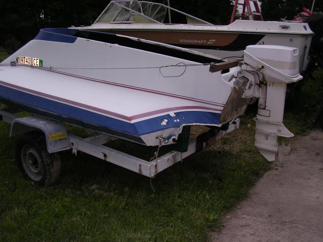

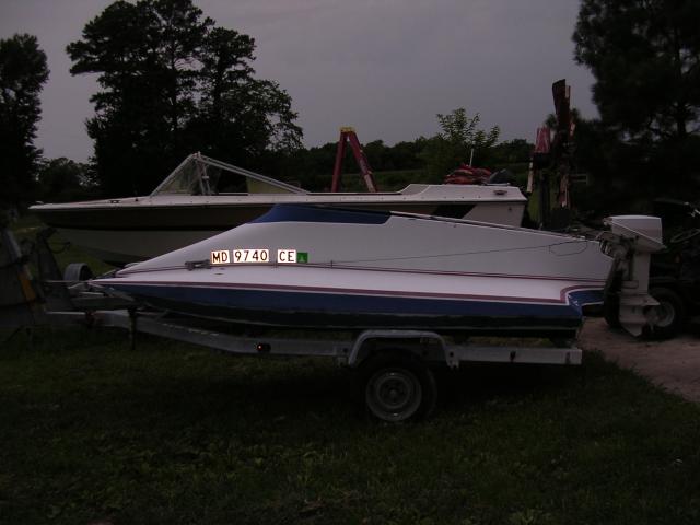

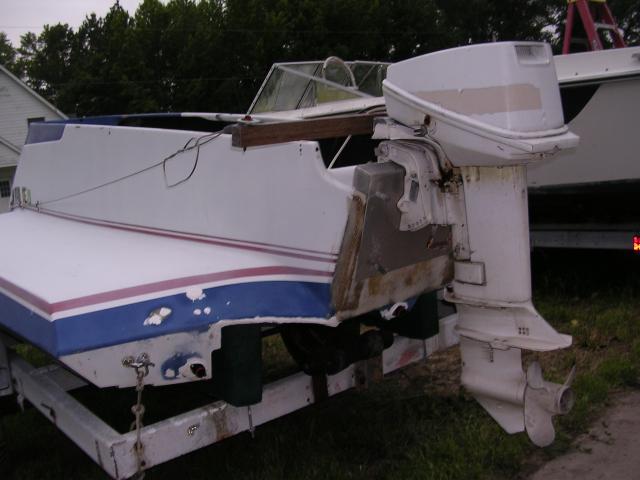

          i'm on the same track pat. if i add the c channel and new lower transom , then she'll go down nice. we had a nephew give us an 88 merc 4cyl 80hp, but its too big, so we're gonna trade somebody for like you said. too bad though cause this one has power tilt also, but too much hp and weight. the enclosed pics show our little project. the past owner had the transom redone . its 16'' to the tunnel from the top, and it's 22'' from the top to the lowest part of the back of the boat. we have the top cover also, but its in the garage. we got the md dnr to give us a title to get numbers because we certified thru the old owner that it had never been titled before , only raced, and they fixed us up to be legal on the water.if got another motor, would the height of this new built transom still be suitable for a short shaft[16''], or should we look for something in the 21, or 22 range?
            Suggest you stay with a 16" to 17" transom (short shaft). You need to keep the Center of Gravity as low as possible. Good luck.
