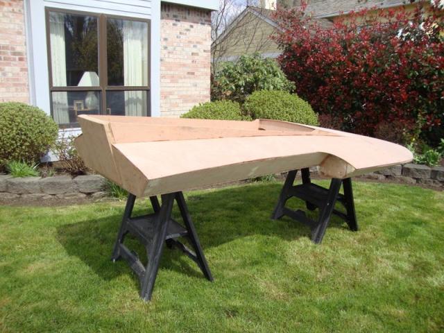

    I am an amateur boat builder and recreational boater who is in the process of completing a 1970's vintage, 10 foot, 3 point hydro called a Super Spartan (see attached). I am considering buying a new 25 HP E-TEC motor because I have heard good things about the reliability, performance and low maintenance of these engines.
    Has anybody had any experience with these outboards?
    Thanks for your feedback.

    Judging from the increase in motor components, I would assume that they are heavier and depending on the length of the drive shaft/exhaust pipe housing, will have a higher center of gravity, and both your boat's transom and motor steering and throttle components will have to be modified to be compatible with one another. I'm basing this theory assuming you will be using standard pulley-steering and a crash-throttle configuration.
    Also, The gear case, being it is a standard fishing lower unit, and bulkier in terms of physical shape, will require some "fine-tuning" in order to produce the greatest propeller efficiency and safest handling characteristics.
    I may be over analyzing somewhat, but this is what I would think about before using a "standard" fishing motor as opposed to a motor already in a "racing" configuration, in terms of steering, throttle control and handling.

      How about using a Merc 25 hp 2 stroke short shaft motor ? Something used ( several on E bay now ) you could use 25 xs linkage for the throttle, a Brown type steering bar -And when you decide to go racing you can build a 25 XS and sell the stock parts to save a few $$
        Using a fishing engine on a hydro style boat is not a great idea, but it will work sort of. See above comments RE overall weight and CG.

          Don't want to tell you not to but, i will! That motor is made for fuel economy and performance but way to top heavy and to heavy all together! If you want to stay with a "Jon Rude" go with the vintage 25hp, 83 94. This motor when built right will run in the high 70's maybe 80's ask DR.Rick Miller. Anyway your boat looks great, good luck Jimmy W.

            Secondly I owned one of these hydros when I was 12 years old. They were built under the names of the "Saucy Shingle" , "Tiny Titan" , "Super Spartan" . A "Popular Mechanic" hydro build they made a fun lake racer. I was fortunate to have a 20H to run on mine. I had a cut out in the front deck with a hatch to place the 3 gallon Mercury gas tank in so I had more cockpit room. The boat ran about 35 MPH with that engine and a 2 blade Michigan wheel prop. For a 12 year old that was more than enough. Boy have times changed. I tend to agree with the other posters here that the E-tech would be a bit much for this hull. I would do some shopping for a good used 2 stroke/15 inch short shaft with the water pick-up in the lower gearfoot. (as opposed to the very early cavitation plate style of water pick-up.) This will allow you to run the engine a little raised on the transom for more speed and better handling. Prop selection will be another issue also so keep in a model year with more current available props such as the thru hub exhaust design. If you can stick with a stock gearfoot you will have more enjoyment out bombing around on your local lake as they tend to have better punch than a pure breed racing gearfoot.

              A 9.5 HP 4 stroke with a stock (shifting) foot will easily plane out a 200 lb guy in that boat and still push it in the low 30 MPH range which is fast enough for that design.

                Ive done some fishing motor/hydro play. It can be done but your not going to be able to depend on it tearing into a turn not to flip & if you blow over the weight & height will work against your saving it. That meaning be careful with set up. Raising the motor above its intended run depth can be done limitedly but without a surface prop it wont do much. Another thing to consider, the motor [any] will only spin so many R's & regardless of weight only go so fast. What youll find is acceleration to be the biggest change when you switch props, the speed will vari a little. If a wide variety of props are available then more potential as well. I drag raced a pal in a hydro similar to mine, his could do about 60, mine barely made 50. We raced about an 1/8 mile, he only started catching up as we ran out of water. Acceleration is fun too & you'll certainly be competitive. I would float the hydro with as much weight as the intended motor [clamp an oldie on that weighs as much] & take a good look, get in & think if you really want to commit to so much $$$ before running it on a low cost used motor 1st. Best of Luck.

                  Thanks for all the feedback. I am going to step back and reconsider my options. I have an older 18 HP Evinrude which I have used successfully on a 8' monoplane called a Minimost. I think I am going to try it first on the new boat and then look at possible upgrades.
