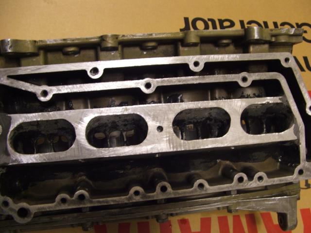

Phase two, The filler block. with the porting done I rough up the surface around the ports (as seen in previous pictures) so when I bed the filler block in the epoxy sticks better.
I have seen the filler block done many ways, from mounting it to the cover plate and running it dry to bedding it in with silicone sealer,. I am not saying this is the best way, but this is the way I do it...

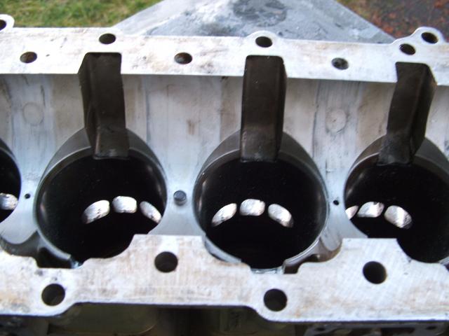

First I fit it to the filler block to the engine block, there are always differences in the castings so there is often grinding on the filler to be done. Make sure that the face of the filler block is at least level with the block face, when in doubt a little loose is better to allow for expansion. Expansion of the filler is a bad thing, it will push on the cylinder wall distorting the cylinder and damage could occur.
To counter expansion I run the filler block wet. First I drill holes between the ports in the filler block to allow water to run through it, usually two in the center and two in the other two bridges and nothing on the ends. Then I drill the water tubes in the block, the ones that look like bolt holes. I try to angle them so that they will be like sprinklers spraying on the filler block. I allow the water to exit by drilling holes in the cover plate so that they will cool the elbows also. While I am at it I also drill out the second layer in the water inlet in the bottom of the block. As a final part of the cooling I drill very small holes in the water jackets on the fuel pump side just to be sure we have circulation and no stagnant hot spots. One last thing, this block did not have the fitting in the top for the pee tube so I drilled and tapped it.

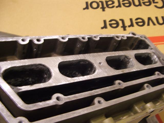

I use Marine Tex epoxy to mount the filler block. I drill and tap small holes in the filler block, then mount angle iron to it to hold it level with the gasket surface. I then coat the blocks with a layer of epoxy and squish it in place. Then using a finger I smooth it around inside the ports and around the outside of the filler block. After it sets up I dress the epoxy withe the die grinder, often a second coat is in order to assure proper sealing.
With the filler block done I install the cover plate and port match that to the filler block, then remove the plate install the elbows and port match those ta assure smooth flow through the exhaust. Lastly I chamfer the ports with that cut off file that other guy mentioned and give the bores a honing.
