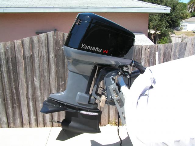

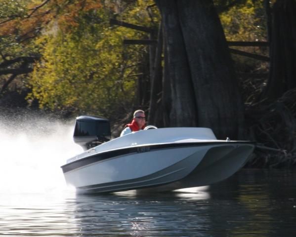

    I do not have a hydroplane but I do have a pretty fast little tunnel hull boat. It is a 13' Biel full tunnel with a 130hp Yamaha. I presently have a Bobs nosecone/lwp but I am losing water pressure and just tired of re-epoxying the lower unit.
    I have decided to try a transom mounted low water pickup. I have searched around the net and presently have a thread going over at www.screamandfly.com but there not much info out there. I was thinking that you guys probably run these and may have some thoughts.

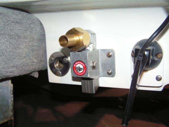

    I just finished mounting a Bobs Machine adjustable pickup. If the wind allows, I will make some passes this weekend with the pickup not plumbed but just want to see how it effects speed and handling before proceeding.
    My initial thought was to reduce drag I would mount the pickup a little high and grind a small "ramp" into the trailing edge of the hull just in front of the pickup to feed it water. I modified the mount to hold the pickup tube flush against the transom.
    I plan to plum the pickup straight to the existing fitting for the bobs nosecone at the water pump cavity.
    I know there will be some trail and error with height but any advice on how to adjust this pick, modify its shape, etc. are appreciated. Pics of your setup would be great.
    My goal is 85mph and I have run 82.6mph so far. I think a little more engine height will get me there.

    Just be carefull!!!!.....You are near'n a point of "break'n-loose"...or walk'n on the prop
    Happens with a hydro when you get the engine set too high in da pursuit of speed.
    With a tunnel you are already high because of the tunnel funnel'n air to the foot......

                This is about 3/8ID but could easily be upsized. By ramping up to the pickup I doubt will avoid much drag because the pitot still has to drag to work, the ramp may even cause more.
                Cool rig! The codes are 'off' so Ill try the pic again later or maybe you can get it from here. Good Luck

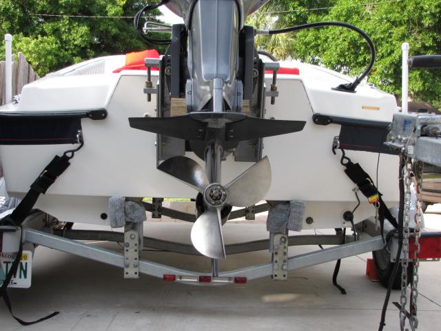

                  I took the boat out and made a couple runs but it was too windy to get a good stable top end run. I decided to go ahead and put the pickup tube in the bracket and beached the boat. When I went to stick the pickup in the bracket, I found that the back of my sponsons were actually sitting in the sand. The boat sits so bow high at rest with nobody in the drivers seat that the sponsons sit in the sand on a gradual sloping beach. This could be a deal killer.
                  I am also going to look at moving the pickup holes in my existing low water pickup/nosecone further back. My eyeball guestimate is that I can pick up about 1/4" more depth. I I remove the nosecone and do some fabricating I may be able to get more.
