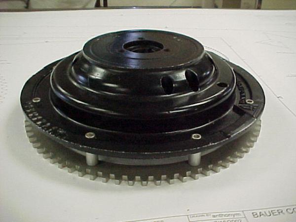

    I guess this will be next thing I make when I get back on the Bridgeport.
    The black Hub will come from a donor wheel.

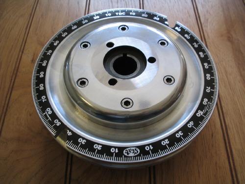

    ide like something similiar to that but be able to run my stock trigger and of course the stock hub to fire it , and stock starter,,,,,any chance????of course on the 49.9 v-rude
      wouldnt want to try to sling big magnets
      maybe would work with a chainsaw ignition.
        I know another guy that would be interested in one.
        But the trigger magnets are already installed in the hub and are small?? So why not just run an OMC trigger?? We don't need the charging magnets anymore, we've got that part figured out.

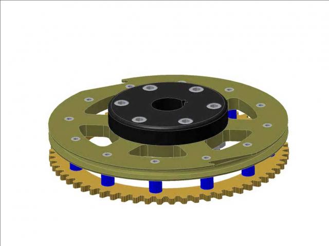

        p.s. Nice drawing, looks just like the one I designed for the MSD on the OMC 49er
        Sattler Racing R-15
        350cc Pro Alcohol Hydro
        TEAM VRP
        The Original "Lunatic Fringe"
        Spokane Appraiser
          my opinion and couple others,,, msd sucks on the 49er,,, and the money ouch,,, soo stock cheep parts would be fantastic on your system anthony and to fit stock starter/location,,, iam deff interested..

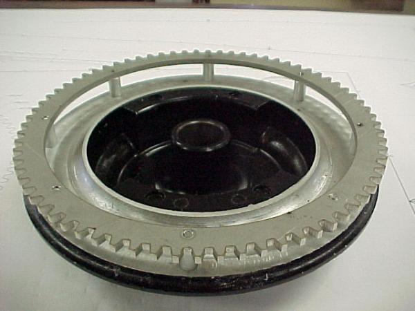

                Looked at stock wheel & Trigger pretty easy,
                Machine the Donor flywheel to new dia, run bolt pattern program
                Machine Pulley Plate Thingy
                Make/buy some spacers
                Have a ring gear cnc'd from 1/4" Stainless
                Check T.I.R. Total Indicated Runout on lathe.
                The second 45 wheel I made was sent to the balancing shop they said it was dead nuts and did not need balancing Nothing like a tight Bridgeport.

                    Ok will make the 49er wheel's compatable with stock trigger & starter.
                    Also machine timinig marks in same location.

                        Following your discussion with great interest. I think form-e one is on the right track with battery powered ignition and inverter produced AC feed to powerpack in order to get rid of the magnets. I still hope he might some day be able to give me a quote for an inverter for my 4-cylinder Force (`98 model with the Merc parts).
                        Anyway, over Christmas I will make up drawing for a battery ignition type forged aluminium (got material in garage) flywheel to be machined by Anthony, using stock hub with trigger ring. Once the 4-cyl has been sorted, the 5-cyl will follow.
