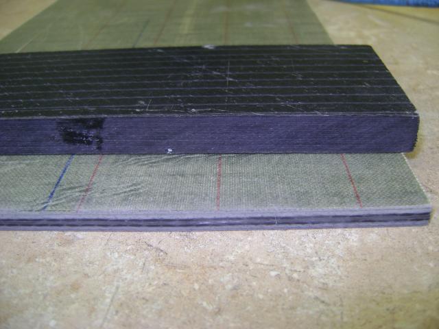

                      If I can steal a moment I will price out some carbon plate in 1/8 3/16 and 1/4inch and see if there is a demand for stock where racers could cut out their own.
                      I have a 30' sheet of epoxy glass/carbon/glass laminate in plate form that is .227 inch thick which was left over from making the top skin for a tilt rotor landing deck to take 15,000 pound impact @ 4 G's. It would make a pretty good turn fin I would think. That black slab is 100% carbon fiber. No matter what the color, It's going to itch when you grind it.

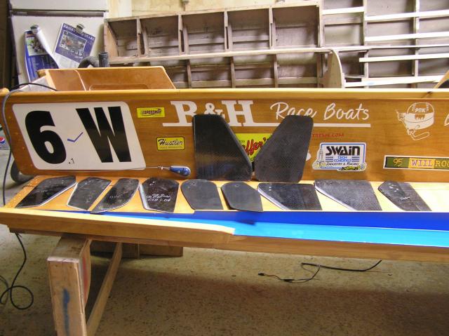

                        Here's a few that we have tested- some all carbon, some carbon with a fiberglass core. Cored fins have unbalance carbon layup with more carbon plies on inside surface. We've been running composite fins for years with no problems save for one delamination (after 5 years of use) where the inside carbon delaminated from the the fiberglass which we think was due to the binder on the glass being intended for polyester resin and not epoxy. A switch to different glass cured that.
