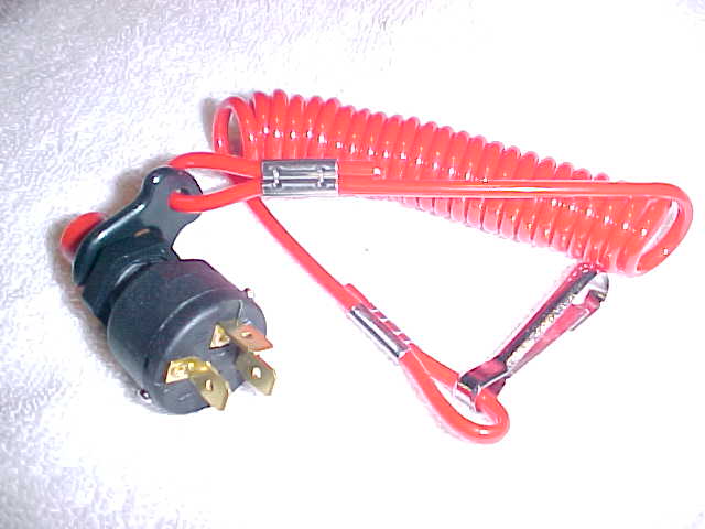

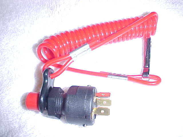

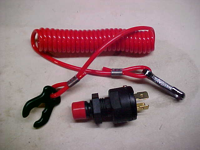

    My brother and I are developing a kill switch that will replace the double kill switch used in stock yamato racing. It also works on the popper and other similar two cyl. mercurys.
    This switch has three terminals on bottom . When lanyard clip is pulled the plunger goes down and grounds both points at same time. Easy to hook up, one terminal is wired to engine block second terminal to one set of points, third terminal to second set of points, any wire can go on any terminal. The design is copied from the Konig switch that Tim was talking about. Testing has been completed and we will be making a 30 piece run this winter. Kill switches will be available next April. We will be making the Konig kill switch also. Samples are to be shipped to Ed Thirlby Sr. soon. Konig kill switch to have larger
    thread to fit the Konig size hole in cockpit or bracket. Stock/mod kill switch will have smaller .625 dia thread that is common in stocks.

                  3 wire kill switches in stock $29.95. With clip installed all circuits are open, when clip removed all circuits are closed. Can be used for all Stock, Mod & Pro racing motors including the Yamato 302, Hot Rods with Motoplat, Konig, Yamato Pro motors etc.
                  The following dealers currently have them in stock. Tom Cronk, Tom Johnston, Dudley Malone, Portage Bay Systems, RPM Marine. All Yamato dealers will soon have in there inventory as well.

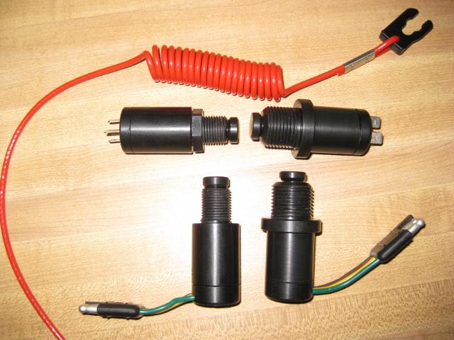

                                Kill Switches
                                These are the kill switches that Marc is talking about.
                                They are machined from black acetyl and you can get them
                                in two different size mounting holes and a choice of spade
                                connectors or a three pole plug.
