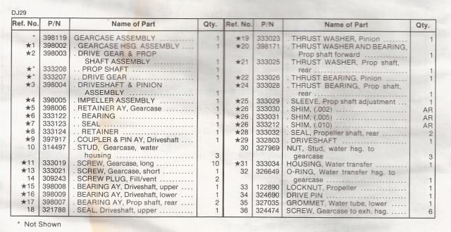

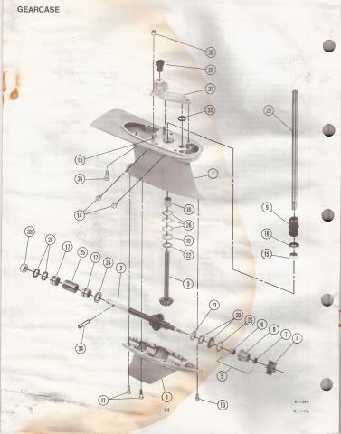

    I am going to take apart an OMC foot to replace the seals and any other maintenance. I would like a parts list and diagram if anyone has one.
    OMC "A" parts list
    Sorry for the water marks. It's my back-up manual.
    Stars on part # list denote non factory parts only available from Outboards LLC or supporting parts suppliers.
