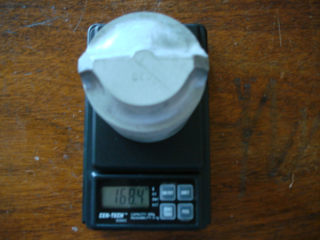

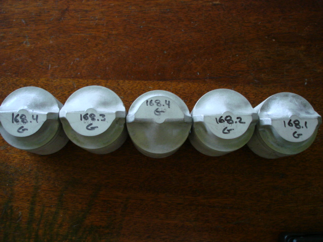

          I have bought 8 sets of these pistons. All 8 sets were weighed and wrist pin height checked against the OMC slugs. Weight of the GLM's veried +/- .3 grams. Not to shabby. I did notice the wrist pin height veried +/- .0005" between the GLM vs OMC. Another engine builder said he had different measurments on the tops of the piston compared to the OMC pistons which caused him to have to change the cylinder head on his motor to make it legal again. I noticed after break-in and some race time on the engine that was to tight to begin with checked .5 CC more after run in. So like I said in my previous post check it to be safe. Hell I have seen two inspectors get two different CC readings on the same motor before so who's to say the thing was illigal to begin with. We don't need to open up a pandoras box here people. The data was collected and presented to the SORC and they felt these were a viable replacment piston. For what we have to work with for parts for these engines I believe they will work if you take the time to double check your build when it's done.
          Tom L.
