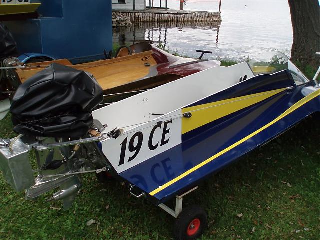

      No cut out
      Here is the photo I remember seeing. No cut out, throttle mounted inboard.
