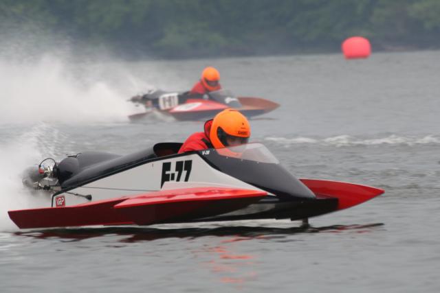

        At 13,440 RPM's
        You probably are going to burn pistons and wear out cranks. I guess you have decide if the ride is worth it or not. Attrition and maintenance are and will always be part of PRO racing. A set-up that completes heats can overcome a faster set-up that leads to early engine failures. Doing your homework and maintenance are important, as is the manner in which one drives the boat. The reward can be a great ride!!
        T. Ziemer photograph
