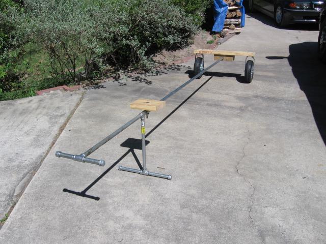

I needed a cart to move my "C" MOD rig around so I looked at all the ways that I might build one. First I decided I dnd not want any welding. Second It should go together easily and third I did not want to spend a great sum of money. What I created with my son was a screw and bolt together design that went together in less than 2 hours. Wheel assemblies cam from tractor supply and are 8 inch. Frame was made from 3/4 in pipe. A few pipe fittings and it was easily assembled. The only metal cutting was to trim the 10 pipe to 8 1/2 feet. If anyone wants a bill of material I can post it. Hope you like the photos of the model 76250 cart. We will now add a couple bits of rug and it is done,
