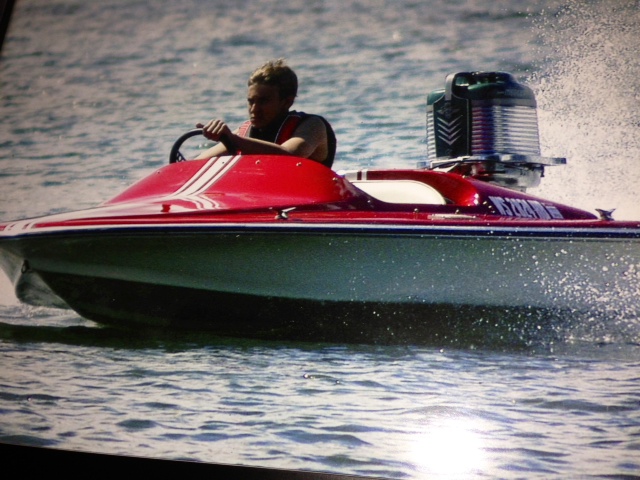

        Looks like in your Avatar you have a Invader. We have one set up to go over 50 mph. We have a ported mark 58 on
        one. Would be a lot safer on a lake than a hydro.Here is a picture of my brothers and nephews Invader.
          Fantastic! Ill be starting fresh without the invader however,
          What size prop?
          Whats the gear ratio?
          By ported do you mean the inside of the carb is polished? Exhaust hole polished up?
          WOT Rpm???
          Thanks for your input, you the man
