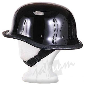

                    Earl-
                    I think this will work for you...............
                      Hey "T" I now owe you one!
