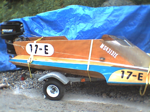

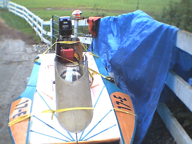

                Hey Jeff, long time no talk! Check your email. My computer fried it's mother board and I wasn't online much at all. I've had some more progress on the turbo four project, I need to put some pictures on my website but the java applicator program won't load , but my java is fine and turned on? I'll have to figure it out, here are some fuzzy pics.
