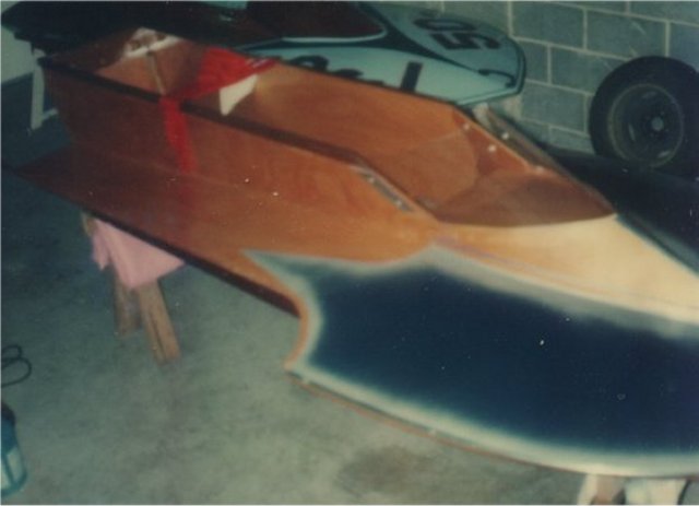

                        I Believe the name is
                        The name you are looking for is Marcell, their dad built the boats, kind of a batmobile style front, the pickles where conected with a concave half circle towards the steering wheel, I thought him and his sister still ran J in 79, maybe it is his sister I remember, anyhow real quality boats, they had a extra deck throttle on the J hydro so the kids could get way out on the bow to get on plane.
                        Kerry

                            I had a Craig Craft back in 1977 and 1978 really fast and floated high and was hard to get the front down to turn on the narrow river courses we race in the east but on the bigger courses it just floated around without ever getting off the transom.
                              Marcell J/A Hydro
                              Tom and Sue Marcell, from E. Islip N.Y. (brother and sister)- Don`t remember their folks first names, but remember them all well. I used to race against Tom in that little home-built back in the day. That boat would fly with an A, but hairy. Didn`t like rough water at all though. Sue ran it some in J, most always out in front with it- and I believe that`s the first time I ever saw a J blow over- Sue came out like a trooper! That boat had a really trick design to it and the wood work was flawless. Mr. Marcell was quite the craftsman. Talk about bringing back some memories....Happy Holidays to all!
