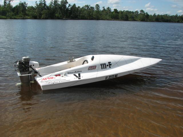

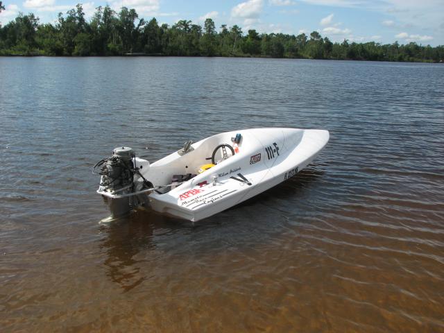

                      here are some close up pics!

                        The boat in the video is owned by a guy named William Haddock that
                        works for me. I designed the boat and William helped me build the
                        tooling. His boat is powered by a 102 and mine has a 302, but both seem
                        to be on par performance wise. The ride is nothing like a flat bottom, but
                        feels more like a hydro ( real sense of floating on air). You don't have to
                        work the bow like a flat bottom. Side to side balancing is the only trick
                        you have to learn which becomes second nature after a couple dozen runs.
                        It rides on a 8" pad with a slight positive deadrise, the rest of the bottom is
                        a deep v. If anything it speeds up in the rough, it seems to run the
                        same speed whether against the wind, downwind, slicked out, or rough.
                        The video was us testing turn fin configurations. Set-up is not much
                        different than a flat-bottom.
                        And yes it is fun to drive! ( a lot easier on the body too )
