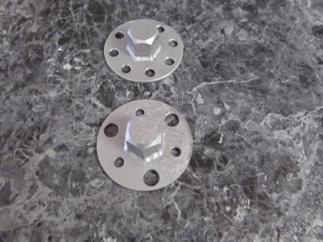

    Starter nut
    You can make a small plate that bolts to the flywheel, almost like a puller. Weld a nut to the center of plate. This way the starter will drive the " puller bolt holes " instead of the crank shaft nut . Go karts use a similar set up on some applications ..
      I've seen them used and borrowed one at a race. No problem that I could see.
        The kart starter is the best thing I have bought in years. I don't like to use the flywheel nut either. I make a plate to bolt on the hub, $45.00 if anybody wants one. Make sure you geta starter with the right rotation they make them both ways.

              Take Larry up on his plate. We build something similar. This way there is no way you can blame a broke crank on the starter.

                You may get along doing this for years but it isn't good mechanical practice to hammer on a nut time after time. I have heard of the top of the crank being broke off. And yea I'm one of them guys that believe in global warming.

                  Order it with optional 2 prong aluminum adapter that engages two holes in crank plate, eliminating stress on top Crankshaft Nut.

                              Got my starter plates from Larry Mac today..This will work perfect after I get my starter
