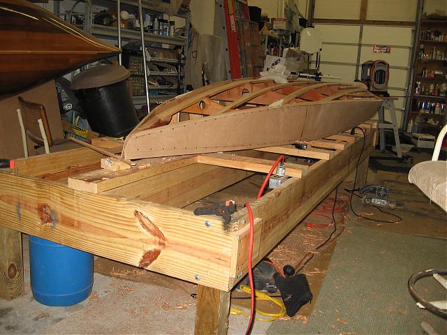

    We have made good progress on our C/D boat. Currently expect to skin the frame during December. We hope to be testing it in January and run some AOF meets. We also have made good progress working with Doug Kay in putting new threads in Quickie lower units. If you would like to see some photos check our website at aeroliner_boats.com. I also have additional photos of the repair if anyone would like photos. My E mail is apvw1@aol.com

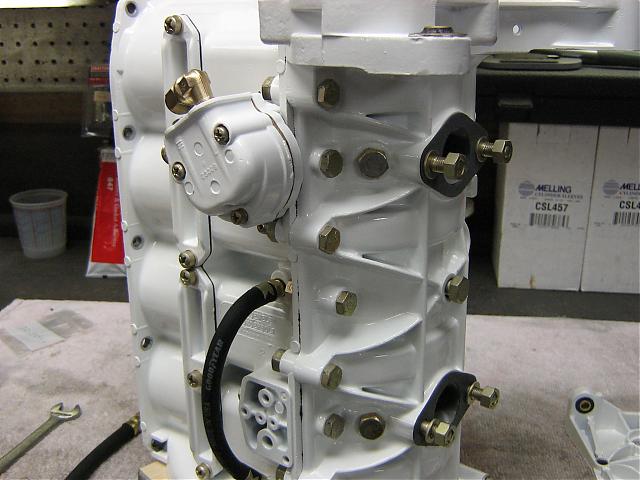

        • Mercury mark 20-H Block repair
          We are working on a resleving of two mercury mark 20-H blocks. We will post photos if anyone would like to see them. They will be broght back to standard bore. So far everything has gone well with the sleve removal and were ready to fit new liners in the block. Once the first two are complete we will also post prices for the repair on our web site. www.aeroliner_boats.com
          Alan

            • Merc parts repair
              As we restore some of the engines that we have and looking at putting together engines that were note 100% we have been able to restore lower units by intalling new cone threads. We have been able to fix all that were bad so far. Additionally we have a number of good blocks that were in sad shape bore wise and now can resleave the all two and four cylinder blocks. If anyone would like some pgotos of the items undergoing restoration please E mail me at apvw1@aol.com. Next summer we are intending to run our boats that were building with our renewed engines. Photos can be seen on aeroliner_boats.com also.
              Alan

                    • KA7A carbs
                      I bought a Mark 55-H with the wrong carbs installed on it. I would like to replace them with a set of KA-7A carbs. Would anyone have a complete set with the choke linkage that they would like to sell. Also like to buy A, B, C, and D lowerunit housings with the threads gone. Thanks for your consideration. My E mail is apvw1@aol.com The photos are of the bloack restoration.
                      Alan

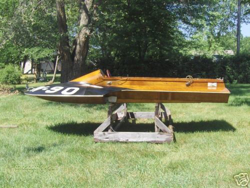

                      • Gerald Waldman Sid Craft
                        I have acquired Jerry Waldman's C-D-F SidCraft and I am now trying to determine the boat number that he raced with for the restoration. I bought the boat from Kirby Pabst on E bay and would like to get some help with the APBA number.
                        Alan
                        • Cool boat, but ironic that Jerry's old boat would have a champion spark plug sticker anywhere on it!
                          Check with Wayne Baldwin about his number, Wayne has more pics from that era than you can imagine...Something is sticking in my head about the number W-2, or W-4 however. Don't quote me though...
                          Bill Schwab
                          Miss KTDoodle #62C
                          • Sid Hydro
                            Thanks for the feedback on where to find the numbers. The boat was owned by a number of folks and raced with different engines. The last setup appears to be for a Konig. To my knowledge the boat has been in storage for a very long period. Luckly it was indoors. I will keep you posted on what I find numbers wise.

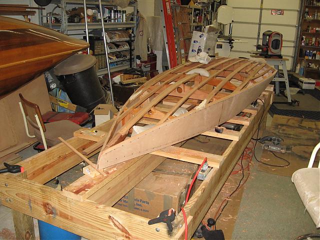

                            • New C/D boat
                              We have been making some progress on our new "D" boat. Sides are on and transom has been finished. We have the bottom cut and ready for fitting. One more weekend and we should have all the major work complete. Hopefully we will complete a second "D" so David and I can run the Top-O-Michigan together next summer.
                              Alan
                              • Fuel tanks
                                We are close to getting the bootom and decks on our new C/D boat. Photos on our web site (aeroliner_boats.com). What I would like to know is the fuel burn for a 44 cu in engine running a marathon. I beleive from my D engies I will need about 6 gallons to run 55 miles. Also do anyone have a contack for a tank fabricator? Planning on running in the Top-O-Michigan next summer.
