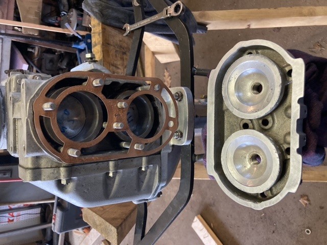

New rings arrived from TJ tonight so I gapped them and threw the cylinders on.
Just last time but now it will have a better head and better ring gap. 16EC8A53-AE9E-45C0-9DF3-2A607B49398E.jpeg

Have you had trouble with leaking head gasket so you do the Cu coat to prevent?
I tried that Cu stuff once and it does have some thickness and noticed a small drop in compression psi, found not needed. I have never blown a head gasket, I torque in 4 steps.
No issues with head gaskets on this motor so far. I guess it’s a habit I just picked up when doing my first turbo diesels with 24:1 compression ratio and an extra 25psi of atmosphere being shoved in the cylinders the head gaskets on them needed all the help they could get.
As I said I’ve just always used it on metal head gaskets. I can see that it would probably cost you a very small amount of compression, but I think it’s worth it when you pull a head and immediately see at a glance if any part of the gasket has had a leak.
