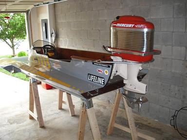

    I have a Class D Hydro which I trying to starting racing. It has a Mercury Mark 55H which runs really good. But I need some tips on proper set-up for this boat. It gets a little scary at top speed and it hard to control. Does anyone have experience with Class D boats that would be willing offer any help?

    a few places to start...
    1. Did you get any testing or set-up info from the boat's previous owner?
    2. Check the bottom for straightness.
    3. Check that the skeg has been properly shaped.
    4. What is the propshaft height and angle?
    I can P.M. instructions on these items to you if needed.
    Good luck, and welcome to the D class.

      Tell us some stats on the boat:
      1) what is the width of the flat bottom at the rear between the air traps
      2) what is the dimension of the after plane = distance from the back of the transom along the air trap to the back of the sponson.
      3) what is the length of the bottom at the centerline from the transom to the front between the sponson pickles
      4) what is the weight of the boat without engine and fuel tank
      5) what is your weight
      6) how far below the bottom of the sponson to the tip of the turning fin when fin is all the way down
      7) what is the dimension along the transom from the bottom to the top where the engine rests without any shims.
      8) as jeff55v suggested check the bottom for flatness. do this for the last 3 feet of the bottom in all directions. a straight edge with a flash light will make this easier.

        Altho Ive never driven a D Ive read that its a big step from C. Not just because of the speed but the difficulty of handling as well. Im interested in reading what turns up here. Best of Luck with it & you definitely asked at the right site.

            Might want to go to in-direct steering, as well.
            Ian Augustine

                Indirect steering!
                Good eyes Ian. I bet this solves a lot of your problems. I don't see a tie-down rope either. Make sure you tie the engine down to the eye bolts sticking out of the transom..and tight! The stock legal max prop shaft height is center of the shaft no higher than the bottom of the boat. Good luck. Keep us posted on your progress.
                Joe 2-H
                  DSH engines should run with a fair amount of kick in and it looks like your skeg has been mangled. Gearcases are very important as speeds increase.
                  Boat looks like an older B&H so we have had some experience with them.

                              Not Might want to.....NEED to.
