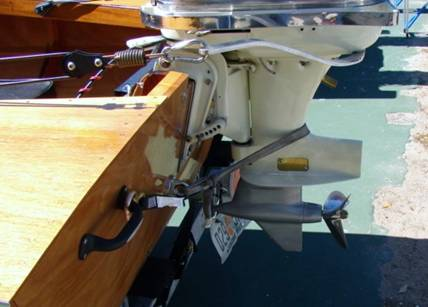

                              Item name: Mercury Outboard Racing D Lower Unit Gear Case
                              Sale price: US $1,384.59
                              This was a M55H lower unit on ebay that went for about where the market is at for these. Some new parts, the 1:1 gears are not new, of unknown origin, and the case has been welded:
                              The Skeg has been professionally welded with a mandrel inserted in housing to protect cone threads and housing bore from distortion.
                              If this had been the newer 44xs case the bid may have been higher. Collectors/hobbyists, are after the 55H ones, as well as Classic racers, driving the price up for non existent (NLA) parts.
                              Other ''D'' lower units on eBay have been going for $700 up to $1000.
