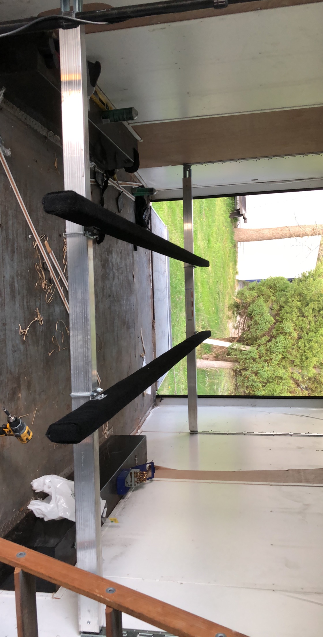

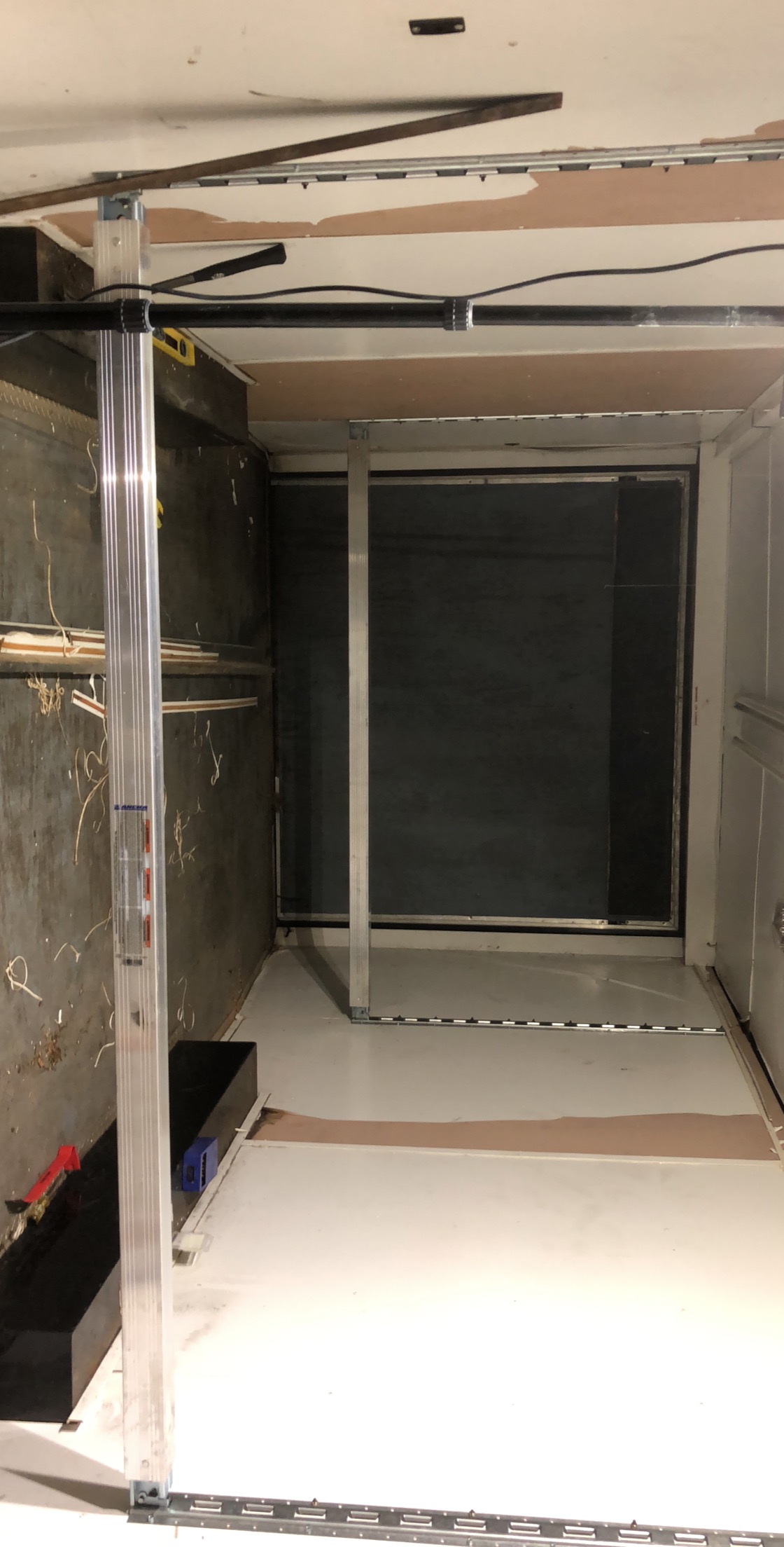

                    I use Verticle E Tracks, Adjustable E Track Load Bars, and 2x4 with outdoor carpet as rails. The load bars hold 2,200 lbs a piece and they are aluminum so they arenít very heavy. Itís fully adjustable for any height and can be easily removed or raised when thereís no boat on it so you can easily walk through the trailer. It also doubles up as a bunk bed with a sheet a plywood for those nights where your crew needs a place to crash. You can also then use the E Track in correlation with straps and secure things to the wall.
                    Dave Cofone and Mike29J like this.
                    • ScatCat
                      ScatCat commented
                      These are great. Can you point me at the attachment fixtures for the 2x4 attachment to the load bars? Looked around a bit and couldn't find them. Can you give me a link, or a name I can use to search? Thanks!
                    Re: Enclosed Trailer Lofting...
                    ScatCat, you can get them at Menards or Home Depot. I had to cut the u bolts down since they only come in one length for the width I needed and then I picked up 1x1 angle iron which you can get from the hardware store. They had stuff with holes already in it.
