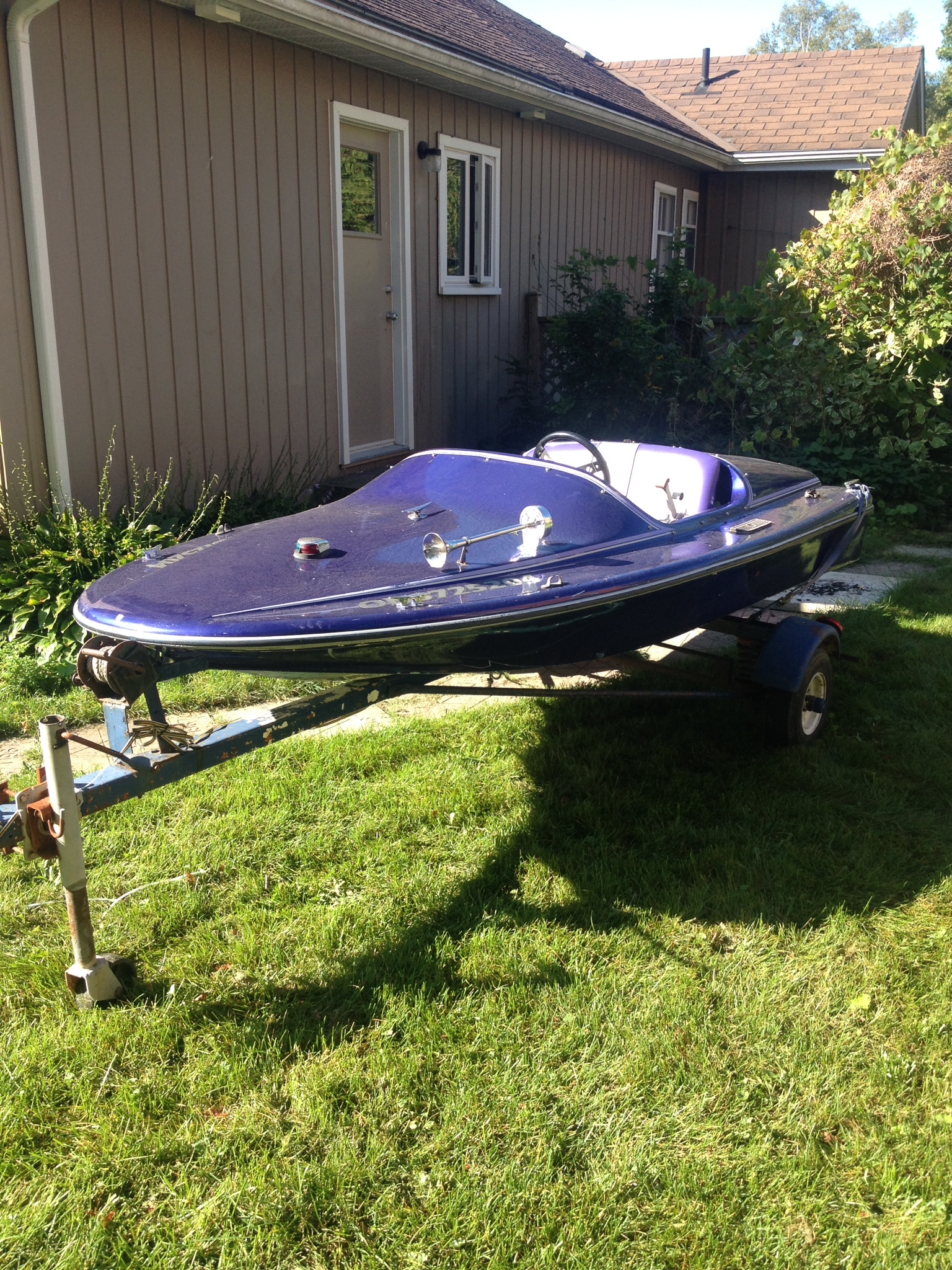

    I have a 10 foot hydro. With a 25hp johnson from 83. It goes 40km. It has a 9.5x 12 inch prop. So. If 15hp can hit 100 km how can i get more speed out of this little guy. Ill never be racing it, its only for my fun. Help me out here guys.

    Hello KH 444,
    So to answer your question of how to get more speed from your equipment, you first need to know how a 15 HP motor can go 100 kph (62+ mph). The people doing this are experienced boat racers. Usually a special designed boat specifically for straightaway runs. The motor is an "A", OMC motor with a racing gear case with a very special propeller for going in a straight line only. All of this equipment is highly tuned and set-up to the max. With lots and lots of testing.
    Your speed of 40 kph (25mph) with a "Standard 25 with a "Non-Racing gear case" is probably reasonable. You could most likely increase your speed by "Jacking Up" the motor on the transom and different propellers. But I wouldn't recommend it. Propellers can be very expensive. Also, we do not know what kind of boat you have.

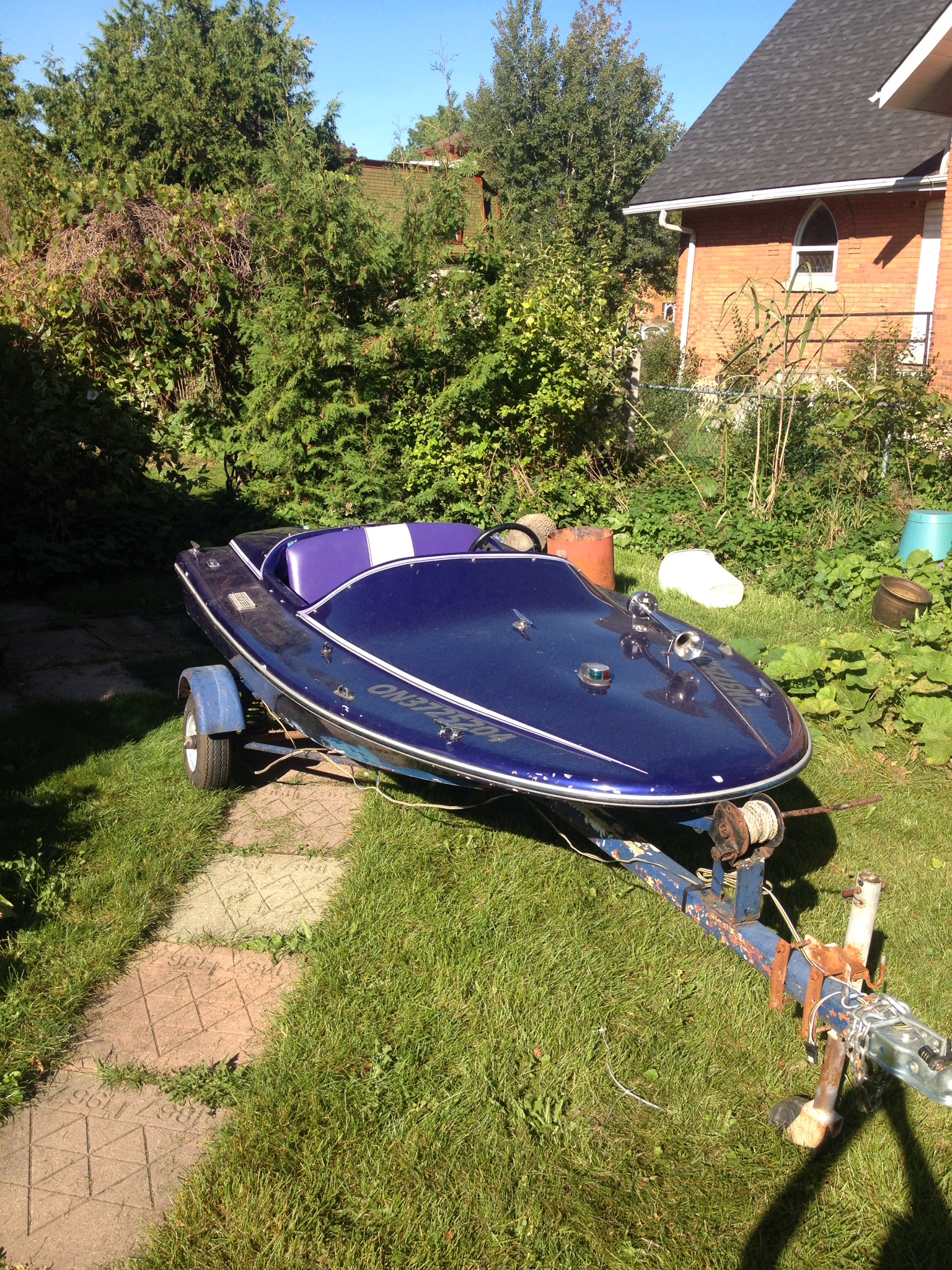

    The boat looks like a G W Invader out of Sharpsville IA. I had on in the early 70 's with a Merc 2 cyl - 35 hp - would run 40 mph with a 17 pitch bronze Merc 2 blade prop. Perhaps a upgrade to a 402 Merc would be the best bang for the buck .

      Yo KH444 Again,
      I thought you had a Hydro. You do not have a Hydro. 25 mph is most likely all you're going to get..... You will need more Horse Power to go faster.
      Good Luck.

        How is it not a hydroplane? I know its not a race boat
      • ZUL8TR
        ZUL8TR commented
        Well on this site a hydroplane has sponsons and rams air underneath, you have a runabout type hull. They have more water drag and more power is needed to overcome that. Race boat doesn't matter it's the design of the hull.

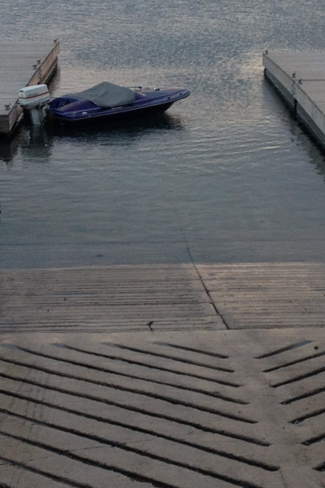

      Your motor is one of the old OMC 31.8 Cubers (521cc). Solid motors. A few things you can do to up the power - your motor shares much with the 35hp of the same era. As such, you can mix and match some parts to get a bit more horsepower out of it. The 35hp carb and intake manifold would be a good start. If your motor has the through-hub exhaust lower unit (exhaust exits the propeller hub) then you can find some pretty good props as that motor and unit were used on some small tunnel hulls. If your motor has the exhaust exiting the bottom of the AV plate, prop selection will be a bit more limited.
      You mentioned adding something to the cavitation plate. Don't. When you raise the motor, it'll be out of the water and will not have any effect on your performance.
      If your motor has the through hub unit, it will have 13:28 gears. If it has the AV plate exhaust, it will have 12:21 gears.

        I can't see the pic well enough to be sure it's not a 22ci but is probably the 31.8. With the non thru hub its 25 or less hp & mid '70s they were all thru hubs later on. Speed can be obtained but bolt on hp w/ better prop choice is easier no doubt. I've done alot of work with a non thru hub & got 52[gps] on a vintage B hydro & 65 on a semi modern C hydro with a Yamato case adapted. The Invader would not perform lke that of course but is a popular boat & there's probably alot of information available on BRF

        Does it have sponsons? If it doesn't have sponsons, it is not a hydro.

          This is a GW Invader. We have one fully restored with a ported Mark 55 on it. You do not want to jack the engines up to far. With a completely
          flat bottom the lower unit is doing all of the turning. You should be able to find props for these engines fairly easily on e-bay. Going one size
          higher in pitch would be your best choice. This will make the boat harder to get up on plan thou.

                  This is a GW Invader. They came in two configurations, one rated for 25hp and one with a beefed up transom rated for 50hp. I have a restored version of the later with a ported Merc44 mounted on a lightweight MK40 service tower and non-shift gearcase. About 55MPH with a bronze Oakland-Johnson prop. A true race motor will not work on this pleasure hull, but a 50hp fishing motor is too much weight. Not a rookie project, but if you can find some help, this is the best possible set up on that boat. Also - the factory steering setup on these hulls is a weak link. Spend some time there including beefing up the dash thickness. Good Luck!
