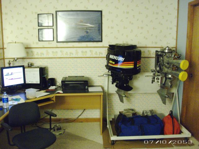

    I save the trouble of carring them down the stairs and just keep them in my home office...gotta keep an eye on them.

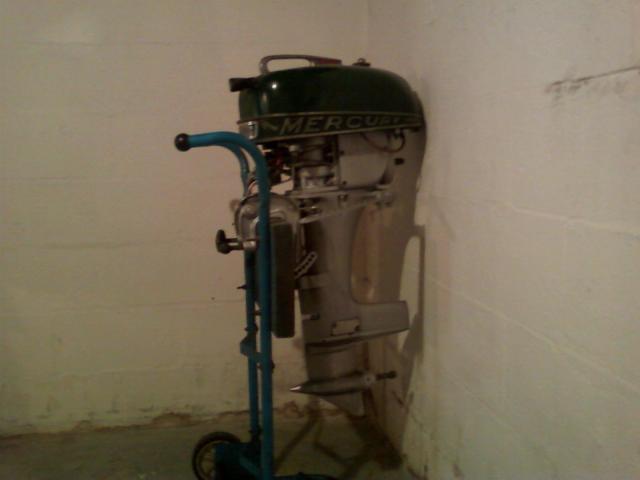

                Here is my girl sleeping in the basement waiting for spring.
                Bob
                      Joe,
                      I remember the days when you stored them in your living room!!!
