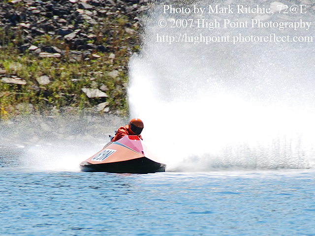

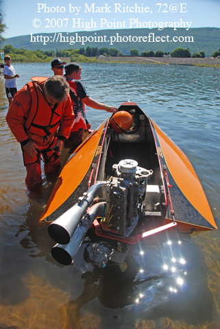

    With all the talk in another thread here on hydroracer.net about wedgies (http://hydroracer.net/forums/showthread.php?t=15286) I wanted to make sure everyone is familiar with George Luce's DMR Super Wedgie.
    From Lock Haven, PA 2007:

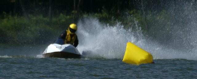

      These are from the Beiswenger project in Fishers Landing. I believe there is a 3rd. boat as well.

          I don't think Luce's boat resembles the Beiswenger boat that much in person. They are completely different from midships to the stern and the purportions are different from the bow to mid.
          Anyone have pictures of the earlier boats other than Krier (I am familiar with them). The Krier boats look more like a box with a point on one end compared to both of these.

            Whether he is building motors or boats there is no denying the fact that George Luce puts together top quality stuff and is a great guy.

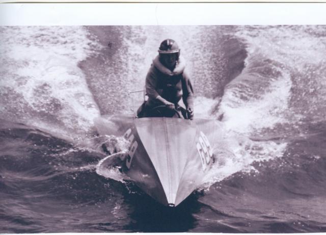

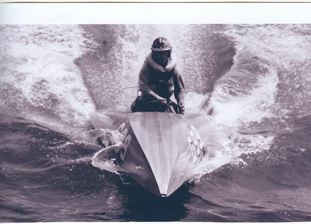

                      The same basic Idea
                      Here is a picture of my Gpa in 1959 Racing his Ashburn Runabout. You can see the similar lines as todays boats. These design ideas have been around for along time! Guys put their own touch on them to make them their own. I have many more pictures of my family and others racing these same boats from the middle 50's through the late 60's. The DeSilva's I believe became more popular as the 60's moved on. These Ashburns were very fast I am told.
                        Re: Super Wedgie
                        You guys' idea of "same" isn't the same as my idea of "same" ... I see big differences in these boats
                          Re: Super Wedgie
                          Similar, but....
                          Almost the same? I guarantee you these two boats perform differently.
                            Re: Super Wedgie
                            I am sure you are right about the preformance differences. I was just saying the deck lines are similar to some of todays boats.
